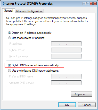

Check whether your network card is configured to work as a DHCP client.

When I'm using this router (one i'm using now to post this) it works fine. So I don't think that there is something wrong with the network card. It is also configured according to the above image (DHCP).
