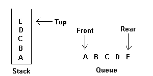

You get the elements as in the following picture.
Now you need to take C out. You need to call as below.
POP (this will give you E)
POP (this will give you D)
POP (this will give you C.. Here comes what you wanted)
stack pointers
On the above image, see there is an arrow with label "Top" that is pointing to the top most element. In a stack, we always point at the top most element as all operations are restricted to that. This pointer is called the Stack pointer.
In that image, stack pointer is pointing to element 'E'. However if you call POP, then then E will be poped out and the stack pointer will be pointed to element 'D'.
