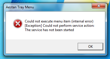

I tried to install the WAMP server in my PC.After finishing my installation I tried put my WAMP server online. But I got this error massage.Can anyone help me on this.

Friends It was a simple error.found the answer from the forum
we can't use IIS, Microsoft Web Deploy, Web Deployment Agent Service, SQL, Skype, Zonealarm
any web related program including Remote Desktop, Teamviewer or Apache, MySQL, PHP outside wamp folder.that was the error
There are some ways to use those programs with WAMP.For example
SKYPE
open Skype > Tools > Options > Advanced > Connection then uncheck "use port 80..." restart Wamp then Skype
there are many other options in WAMP web forum.you can read them as me!
