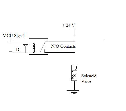

Hi Friend ,
Here is the circuit for connecting the Relay. Make sure to connect a Diade ( Rectifier Diode like IN 4001) inbetween
the coil of the Relay. (Between two control signal terminals) Diode should be connected reverse bias. This Diode is very much help full to avoid restarting the microcontroller , when the relay is operating.
And it is better to connect the microcontroller signal to Relay through a opto couple. This will minimise the effectes of external circuit , to the microcontroller control circuit
Good Luck
