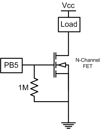

Here is a circuit diagram.
Keep noted that FETs are more susceptible to static electricity damage. However don't worry too much on this.

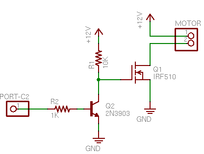

A good way to drive an FET is by using a transistor as in following circuit diagram. Keep noted that following circuit will invert the uC output.

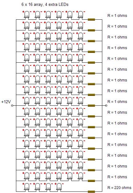

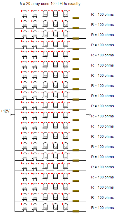

Another question is, how did you connect 100 LEDs?
If you have connected them in series, you might need a power supply of ~300V.
Here are two options for you to power 100 LEDs. I have considered following figures for this calculation.
Source voltage: 12
diode forward voltage: 2*
diode forward current (mA): 20*
number of LEDs in your array: 100
*See 5mm LED typical technical data
Option 1:
  • each 1 ohm resistor dissipates 0.4 mW
  • the 220 ohm resistor dissipates 88 mW
  • together, all resistors dissipate 94.4 mW
  • together, the diodes dissipate 4000 mW
  • total power dissipated by the array is 4094.4 mW
  • the array draws current of 340 mA from the source
Option 2:
  • each 100 ohm resistor dissipates 40 mW
  • together, all resistors dissipate 800 mW
  • total power dissipated by the array is 4800 mW
  • the array draws current of 400 mA from the source
If you connect with option1, it only takes ~350mA. So you'll be able to use transistors that can cope up with it such as BC337 (500mA), 2N2222 (or PN2222A) (800mA), 2N3568 (or PN3568) (500mA).
