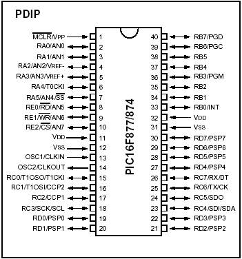

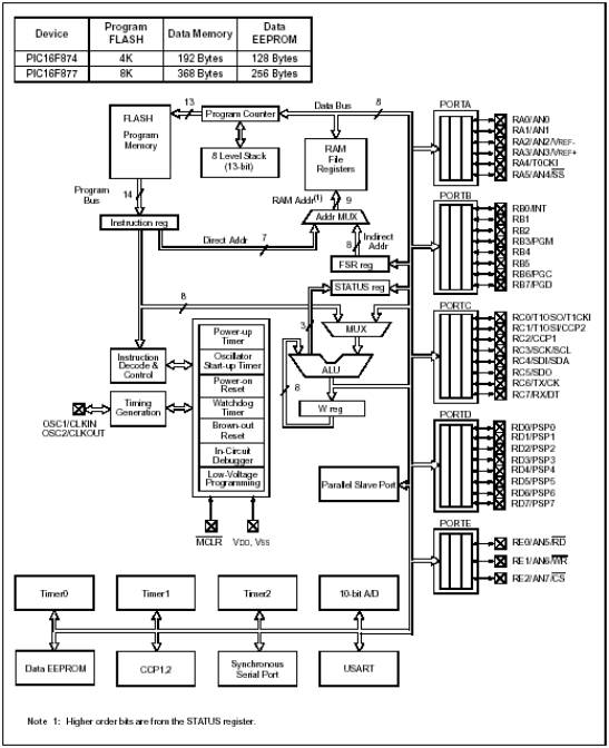

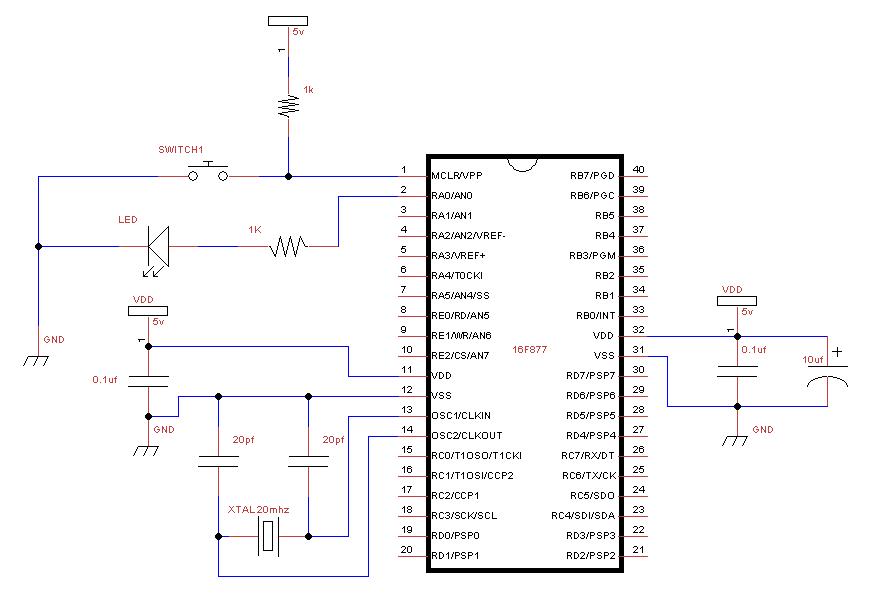

      First have a look at the pin diagram of PIC16F877
      You can see that the PIC16F877 has many number of I/O ports that can be used for number of purposes.
      For this tutorial lets use a single LED circuit as in the schematic diagram below. We are going to blink this LED every few seconds.
      PIC Power Supply
      LED Circuit
      Note: Use a 4 MHz crystal oscillator insted of the 20 MHz one in the diagram (denoted as XTAL20mhz)

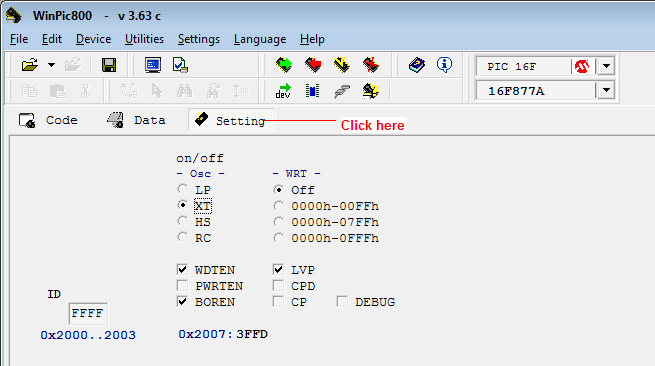

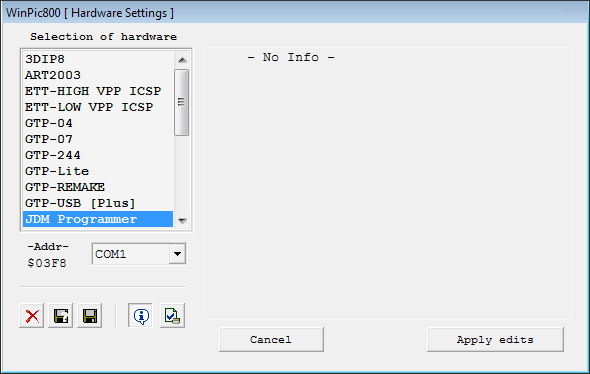

    3. Chip programmer
      To program the chip use either WinPic800 or IC-Prog Prototype Programmer. For this tutorial, I'll be using WinPic800.

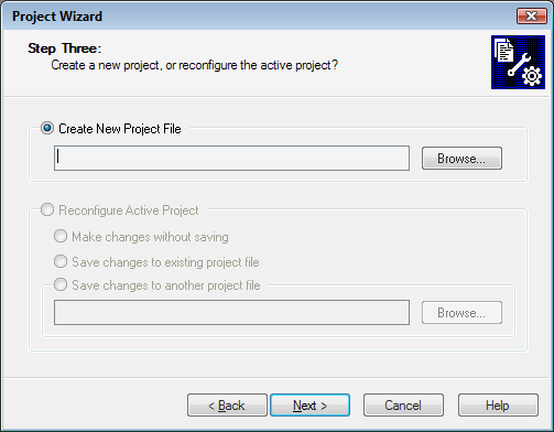

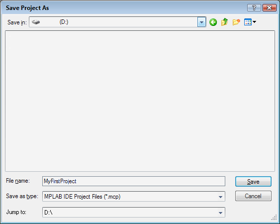

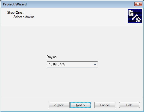

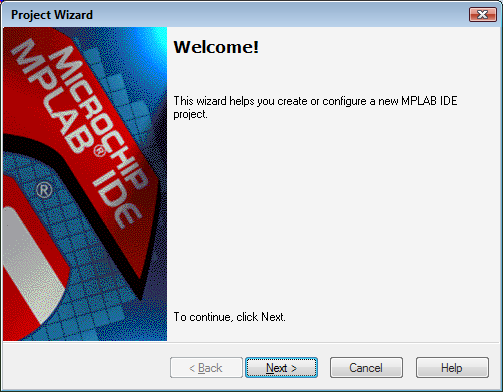

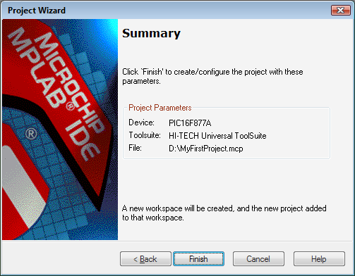

  4. Configure MP LAB and HI-TECH C compiler
    Once all these are prepared, next step is to prepare MP LAB and HI-TECH C compiler work together.
    1. Install MP LAB and HI-TECH C compiler to your PC

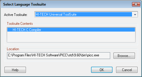

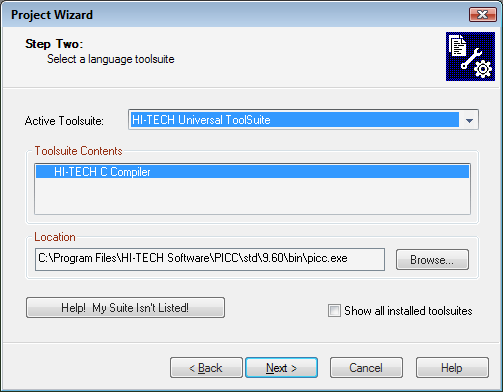

    2. Open MP LAB
    3. Go to Projects menu and click on Select Language Toolsuite...
    4. Select HI-TECH Universal Tool Suite from the list
    5. Click on Browse button and set the path to picc.exe as below
    6. Click Ok button

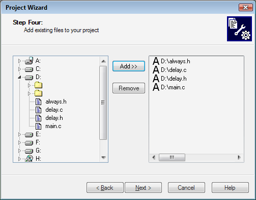

  5. Save 4 source files to your disk
    Now, we have setup the HI-TECH C compiler to MP LAB IDE successfully. Next step is to write the program. I'm sure most of you are interested in this step.
    First note that, we have connected the LED to First pin of PORT A (RA0).
    Save following 4 source files to disk in given names.

  6. Create a project with MP LAB
    In this step, we are going to create a project using MP LAB.
    1. Go to Project menu and click on Project Wizard
    In the next step you need to select the main.c and the two delay files as listed above.
    Click on Finish.
    On MP LAB, you will see a window named as MyFirstProject.mcw as below.
    If you don't have it yet, you can get it by going to View menu and clicking on Project. You will see all 3 files are attached to the project now.

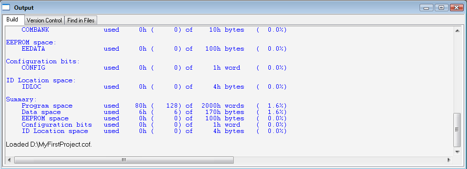

    Now, we need to compile the project.
    Go to Project menu and click on Build (Alternatively you can press Ctrl+F10) to build the project. You will get an output witndow as below.
    Check whether you have a file called MyFirstProject.hex in the project folder. This is the output file that is required to burn to Flash memory of 16F877 Microcontroller.
  7. Burning the Hex file to Microcontroller
    We will be using WinPic800 to do this.
    1. Insert the PIC16F877 microcontroller to the ZIF socket of the programmer in the right direction
    2. Plug serial cabel from PC to Programmer board
    3. Install the program and run WinPic800 executable
    4. Click on Settings menu and click on Hardware
    5. Select JDM programmer (As above)
    6. Now select the COM port. For my system I have selected COM1.
    7. Click on Apply edits
    8. Click on Settings button on Toolbar and make the settings as in the following screenshot (if different).
    Now we are going to program the Hex file to PC16F877 Microcontroller
    1. Select PIC 16F and 16F877A on the controls at top-right corner as below.
    2. Now click on Erase All button to clear the Flash memory of the microcontroller (This step is not essential). Notice the LED of the programmer which should blink while programming the flash memory.
    3. Now, go to File menu and click on Open
    4. Select the Hex file that was generated before
    5. Now click on Program All button
    6. After the process is completed, click on Verify All to make sure data is written successfully
    7. Done!
  8. Running your first microcontroller program
    We are going to run the code that we have just flashed on our custom board now.
    1. Place the microcontroller to the custom board (or breadboard)
    2. Now, switch on the board
    3. You must see the LED is blinking on custom board
This is the end of the my microcontroller tutorial. Let me know your ideas, comments, etc... and if you have questions, please ask under this post.
