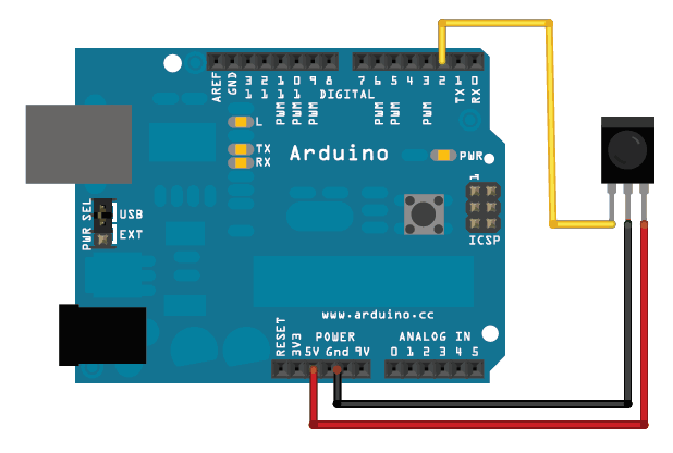

If you bought IR Receiver Module Wireless Remote Control Kit for Arduino from TRONIC.LK, here is a quick guide on integrating that to Arduino or any other microcontroller based board.
Connection diagram.

  IR Receiver TSOP382: Supply voltage of 2.5V to 5.5V
  With the curved front facing you, pin 1 is on the left.
  Attach
    Pin 1: To pin 2 on Arduino
    Pin 2: GND
    Pin 3: 5V
