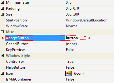

I have a login form and after filling the fields, I'd like the user to be able to press Enter and it should act the same way as if the user pressed the submit button.
Re: Combobox and a wish....
Posted: Thu Feb 04, 2010 8:09 pm
by Neo
On the form properties (not button properties), find AcceptButton and set it to button you want to act as the default as in screenshot.

One more problem, I've just tried this. And this is working but I have vistaButton (a custom button made from code) and it isn't appearing in the acceptbutton property.
What do you think I can do? - Its just next to impossible changing all the buttons and am worries about messing up things since the time is not much.
Thank you.
