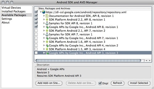

  4. Now the Android SDK and AVD Manager window will appear. In the left column of this window, click the Available Packages button. Now you will be able to download the repository, which will provide you with more download options.
  5. Once the new download list appears, you will want to select the items shown in the image below, which include some necessary resources and tools as well as the OS itself.

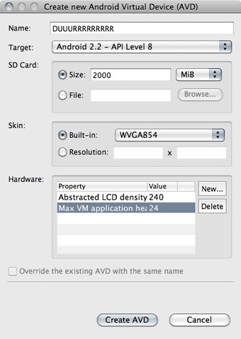

  7. Now you are within the “Create new Android Virtual Device (AVD)” window, which is where you will configure your Android emulator or virtual environment. You can fill out these settings to your preferences. Keep in mind that you will want to make sure Android 2.2 – API Level 8 is selected under Target. You will also want to select a screen resolution that works best for your display.
  8. Once you have configured the emulator to your liking, click Create AVD and wait for the process to complete.

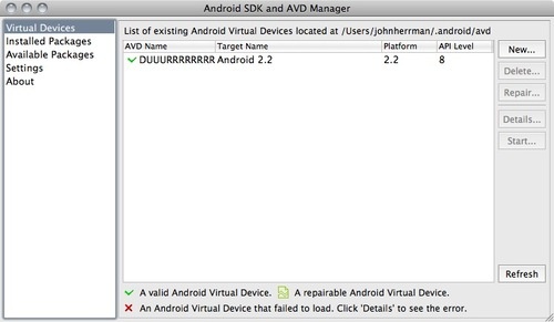

  9. Now, from within the Android SDK and AVD Manager window you will see the emulator or AVD you have just created in Virtual Devices in the left column of the manager window. Now you can simply select the AVD you have created and click Start.

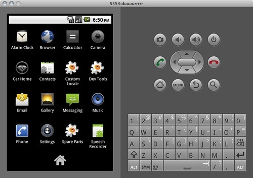

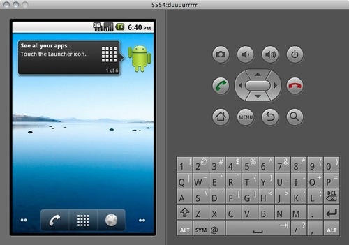

    The emulator should open automatically and you will be able to try out Android Froyo!

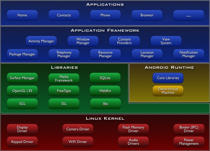

There is something called Android Native Development Kit (NDK) which allows you to write programmes for Android using C/C++.
Android itself uses the Linux kernel, written in C. The Davlik VM, as well as the JRE, are written in C++. So it is C/C++ which plays the real role there. However develop applications using Java to Android could be much easier than with C/C++.
All parts in Red, Greed and Orange are 100% written in C/C++. Most of the parts in Application framework are also written in C++. Users can write Applications using Java (or C++) to Android as represented in the top most layer.
