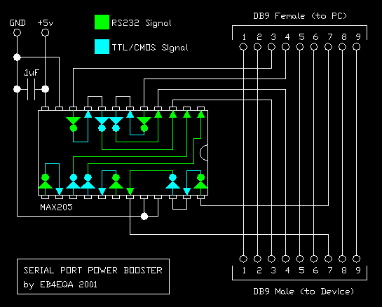

I have found this circuit, as a alternative.
circuit:
Question [where to buy?]
But the real problem is , is there any already implemented power boasters in the market.
Don't suggest me to seek on ebay, I mean pettah local market or unity plaza.
question [ will providing power externally on the fly will work?]
is that just remove up the Vpp pin from ICSP circuit and externally provide power using a LDO
will fix the problem ?
Question.
also , if that MAX205 chip available on the market ? Where could I get it?

Using low speed settings on programmer will fix this problem?
No, I don't think you can do that. We have tried this long time ago. Basically we found that those programmers need standard RS232 spec. 5V is not enough. This is the reason for us to for PICKIT2 and 3. I'm not doing marketing here. But I'll tell you some advantages over the serial programmer. You can directly use MPLap to program chips (no need to install external programming software such as WinPIC800). The most important thing is you can also debug your code in addition to just programming. Let me know if you need this. I'll give you a discount since you are from ROBOT.LK.
Not available in Sri Lanka but if you want, we can add that to our next order.
If you can carefully do that, it is possible. Otherwise it will blow your motherboard. So not worth to try.
As said, you can write to TRONIC.LK on that.

And yes, I think I could make the JDM programmer with external power supply, it will solve the problem
with programming ICSP compatible chips. [Programming only, please note that there are 6-wires in this ICSP originally,
the last wire is a debug wire , which is not supported with that JDM modified one].But either way, I have highly required
[there are other interfaces like ex FBUS, I need to deal with]
to buy a ready made Boosted power serial or parallel converter
If that kind of ready made stock is there in your
stock or you could import it, let me know. In that case I'm pretty straight forward to buy it.
[please note that the circuit that I've posted about does not contain a power LDO's or any transient protection ,
neither the Power Booster circuit using MAX205. So it won't make FC or RHoS standards at all].

Regarding the circuit diagram. Electronically I don't see a problem. As long as you have an external power, it should work. Do some R&D.
