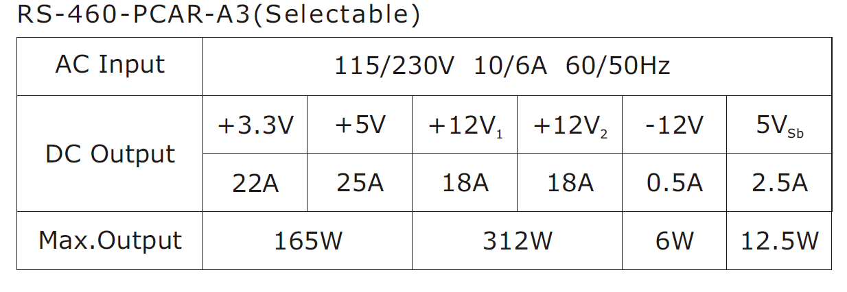

Can't say much about your power supply. It is not just the Wattage. Need more parameters like the power it is delivering through the +12V lines etc. If your power supply is a no-name one. You are probably gonna have to upgrade to run a high end card, even the current mid range ones. Eventhough your power supply might have a label like the following. It can not be trusted unless it is a well known brand.
The above chart is for my power supply. It is a Cooler Master 460Watt one. It can deliver a maximum of 312Watts along the +12V lines (all of them combined). So I can safely run the 116Watts gfx card off a single rail.

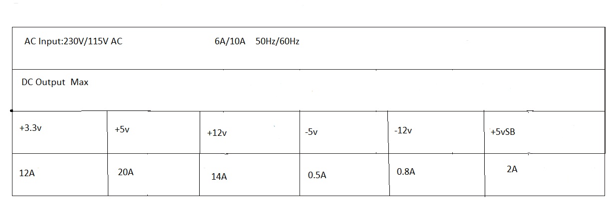

Here is what I have on my PSU as I see its name is GTS
I've edited your image to add my PSU's values :D It's bit ugly :D

12*14=168
So, 168Watts on +12V rails. That is the maximum. And a 100Watt card might work or it might not. Not sure about that.
