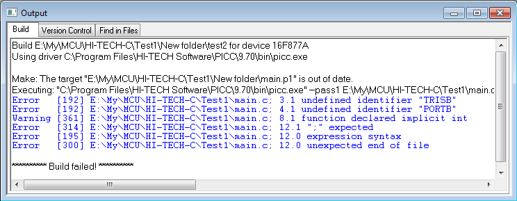

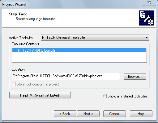

I have started to coding with HI-TECH C compiler.I have used MPLAB IDE.
Please,tell
1.Is HI-TECH C a compiler? And,Is MPLAB a IDE?(don't write more,please tell Yes or No ;) )
2.Am i correct that compiler settings in MPLAB?(tell more about this :) )
3.I coded small project like this.But,Compiler give me "Build Faild" :cry:
void main(){
	TRISB=0;
	PORTB=0;
	do{
		PORTB=~PORTB;
		Delay_ms(500);
		}while(1)
Build Failed
Build Failed
Please,give me some example code or links.

1. Yes and yes
2. Seems correct. Not sure since I normally use C18 compiler.
3. Seems like you didn't include the header file.
Under the projects tab in MPLAB expand your project. Then right click on header files and select "add existing item". Navigate to where you installed your compiler (not sure about hi-tech compiler but for C18, it's C:\Program Files\Microchip\mplabc18\v3.40)
Then there will be a folder full of files with the .h extension( header)
Find the file that says - PIC16F877A.h or something similar and add it. It should compile fine.
Yes
Correct. See Neo's great Microcontroller tutorial How to start with Microcontrollers.
Two problems.
1. You need to put, #include <pic.h>. In some HI-TECH compilers, you need to use #include <htc.h> instead.
2. Loop has a syntax error. You need to put a semicolon after while(1).
Your corrected code will look like below.
#include <pic.h>
void main(){
	TRISB = 0;
	PORTB = 0;
	do{
		PORTB = ~PORTB;
		Delay_ms(500);
	} while(1);
Please note that I hate to see codes with bad indents (correct tabs). So please be kind enough to maintain indents correctly as pasted in my code.

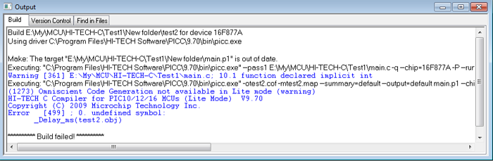

According to Fox said,I could found .h folder of HI-TECH C Compiler.In my machine,path of it is "C:\Program Files\HI-TECH Software\PICC\9.70\include".This folder has lot of header files(189) and one text file(readme.exe).
But,pic16f877a.h or pic16f877.h not exist. :(
in readme.txt has this text.
PLEASE NOTE:
	Some devices share the same header file, therefore you will not find
	one header file per device.
	You need only to include HTC.H in order to get the Special Function
	Register (SFR) definitions. The HTC.H header file will automatically
	include the header file for the device you have selected.
[/color]
Therefore,I included htc.h file for my project.But,Now has other Error in building.

It's not pic16F877.h it's "16F877.h
But Use htc.h as sevenzero told.
And sounds like Delay_ms() is a macro, and that macro needs you to define your oscillator
frequency.
#define FCY     40000000UL
correct value may depend on your crystal , I have configured it for 4MHz.
Since htc.h or pic.h are general include files you need to say your crystal frequency
in order to generate that macro.Otherwise it will be a undef.
EDIT: Ops you're using lite edition right. I think you need to do a helder file injection in
this case. Dig this http://www.edaboard.com/thread210298-2.html , sounds like you
need to write your own.
And sevenzero, are you on complete version of Hi-TEch c , can upload the delay.h ?

SemiconductorCat wrote:And sounds like Delay_ms() is a macro, and that macro needs you to define your oscillator
frequency.
How am I define my oscillator frequency?
I included your code like this.But,Not change...
#include "pic.h"
void main(){
	TRISB=0;
	PORTB=0;
	do{
		PORTB=~PORTB;
		Delay_ms(500);
	}while(1);
however,How am i use this Library function in my code?
is library function equal to macro?

Post by SevenZero » Sun May 13, 2012 10:31 am
I asked you to go though Neo's How to start with Microcontrollers tutorial. Everything you need is there.
You need to make those delay files and include the delay.h.
Within delay.h, notice #define PIC_CLK 4000000 //4Mhz. That's it!

Try define FCY thing above the include.
To answer your question about macros , you need to turn a C++ book up and read a chapter about
Preprocessor. Functions or inlines are better than macros. But still we can't live without preprocessor.
It's not possible to live without preprocessor.
But I think here the real problem is the lack of delay.h in your lite edition. I think sevenzero could post
his one. So you could do this injection.
EDIT: Neo have that already, Yes add that delay.c and delay.h to your project as neo told.
So sounds like we all using lite edition right !

But I think here the real problem is the lack of delay.h in your lite edition. I think sevenzero could post his one. So you could do this injection.
There isn't any delay thing built-in to HI_TECH C. You need to write something by your own or else found someone else's.
No. It's not because of Lite Edition thing. You will find a delay under samples in Standard Edition but it is completely different to what Neo has added. So it is that you need to write what you need as you need with HI-TECH C. Nothing built-in including the processor definition file.
