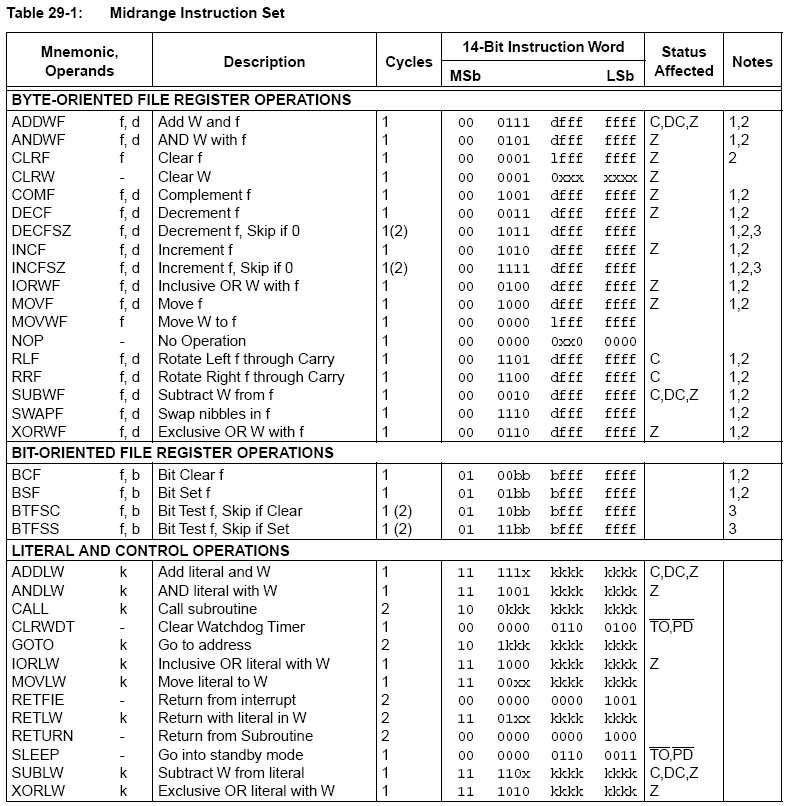

Thank you for your effort of reading the assembly language instructions.
A Book? Your refering to this : Instruction set manual. This is embedded in your datasheet for sure.
Probably in appendix.
http://ww1.microchip.com/downloads/en/D ... 31029a.pdf
page 29-3 chart. table 29-1.
No need to print the who book, print this page. or at least keep a written copy of it.
addwf pcl,f
it says add the register f to the pcl.
where pcl is the program counter. you need to read the core PIC16FXXX core architecture.
As in general processors program counter is the register where we keep the address to the
next instruction. So next instruction will be somewhere in the table according the the value
of f.Note that f=0xF so it's will be interpreted by compiler as '1'.
See that's how it generate it.[page 29]
Add the contents of the W register with register 'f'. If 'd' is 0 the result is stored in the
W register. If 'd' is 1 the result is stored back in register 'f'
So could you need to read it.
movlw 0x25
Again take the chart and seek for movlw, it says
move literal to W. Where literal is 0x25.So after executing that instruction the w will be 0x25.
Just don't try to take everything to your head like your programming your microcontroller.
Experts even referring to manuals. Let it happen automatically. A one who wrote a PIC assembler
in SDCC IRC channel at freenode told me "please wait till I refer the docs".
So be very straightforward to refer it. It will automatically go to your brain.

I have some problems.
1.What is PICmicro MID-RANGE MCU FAMILY?
2.Explain this 4 and 5 columns in table 29-1.
Table 29-1 _ Midrange Instruction Set.PNG (98.06 KiB) Viewed 18754 times
3.What is this STATUS Register's Z, C, DC and OV bits?(I could understand some,using some example code in Vidusara artistic.But,I haven't more clear.)
Thank you...

SemiconductorCat
Posts: 455
Re: Assembly_7segment_counter
Post by SemiconductorCat » Thu May 17, 2012 10:08 am
as they said mid range means 16FXXX MCUs.
2. As it described in the manual, before the chart , 'f' refers to a register or a memory location.
So the bits marked with f will contain the address of the register. [Since the register file also
located in general purpose ram ]. So there are 7 bits for register/ram filed. Which means this
PIC16FXXX micros could access 0h-0x7F , but I'm pretty sure your micro will have limits ,because
SRAMS are so expensive.
k is used to represent a literal ,refereed to a constant in C.
d represents a single one bit. It will decide the direction of the data flow.
if d=1 then result will written back to the register.
if d=0 then result will written back to the W register [working register]
Is these things so hard to read and understand ?
X refereed as non used. So it's value will be ignored.It does not represent any
meaning or affect's anyway to the instruction's operation.Microchip assembler
will generate logic 0 on that place, but as it says it could be 1 or 0 don't care.
3. Status Register.
come on read the section 2.3.1 , under memory organization->special registers->status register.
Simply Z means zero, if your arithmetic operation will generate a zero result this will be 1.
C means carry bit, if your arithmetic instruction will carry [for a example add 0xFF to 1,
example
movlw 0xff
addlw 0x01
Then carry bit will be one.
Overlfow [OV bit]
Where is the OV bit in your microcontroller. However there is a OV bit commonly used in other
microcontrollers/microprocessors. OV bit is not related this micro. However I'll discuss it.
Generally we use 2's complement notation to keep signed numbers in memory. Where the MSB
[Most significant bit] will keep the value of the sign. For a example -1 is denoted as
-1= 0xFFFF in 16 bits.
where higher MSB bit is equal to -65536 [-2^16]
and other bits [ 1+2+4+ ...+ 2^15 = 6555 (http://www.wolframalpha.com/input/?i=su ... 15+%2C+2^x)]
represent positive. So that's how -1 comes into.
So the case is when there was an overflow from the 15th bit to the MSB bit, the result will be wrong !
It signal that , microprocessors implement this bit. So you need to check for Overflow flag after every
signed arithmetic instruction.
Anyway love reading your manual, it will make you smart, then you could read other manuals with
no exercise, like I did for you, Where I originally coming from 8051 , I have very less experience
with PICS. You can see most of the things in here like Z, C, OV are eveywhere in computing not
only limited to your specific microcontroller. So read it and partice reading through it.
It will make you smart. You many read this manual hard but next time you are reading a new manual
of complete different microcontroller, you'll figure the things out within seconds. So take my word
on this.
