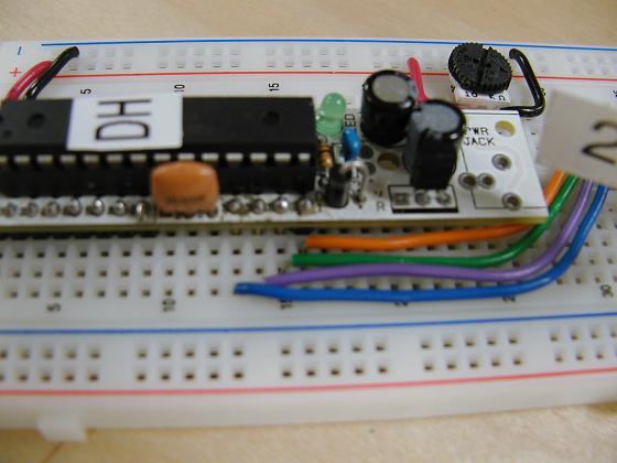

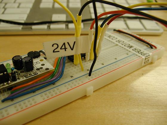

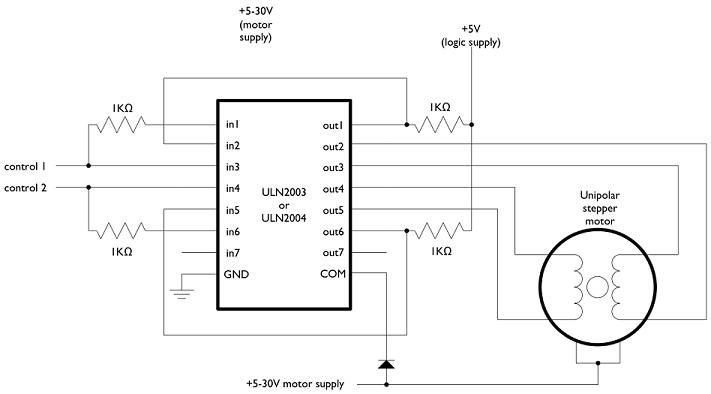

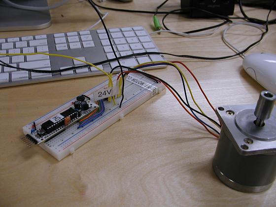

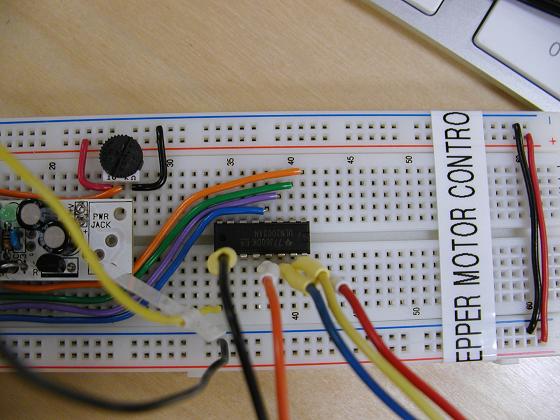

This page shows an example on how to drive a unipolar stepper motor. These motors can be found in old floppy drives and are easy to control. The one we use has 6 connectors of which one is power (VCC) and the other four are used to drive the motor sending synchronous signals.
ULN2003A driver chip has a bunch of transistors embedded in a single housing. It allows the connection of devices and components that need much higher current.
