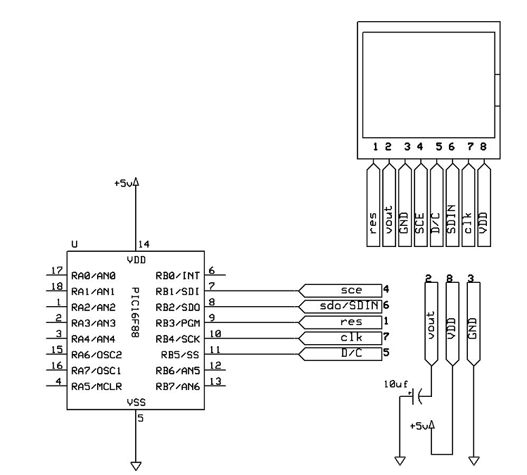

I wondered for some time which LCD would come handy,easy ,affordable & available :)
So finally I figured it out that Nokia 3310 LCDis a good solution :)
LCd_3310.rar
Here are my project files
(98.15 KiB) Downloaded 782 times

Very good one. Zoomed out image of the same is attached here.
Datasheet is here.
