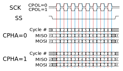

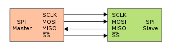

Semi says about SPI, but SPI also needs an accurate clock. Jerky clocks will tend to disrupt communication and introduce lot of instability to overall system.
How it's impossible ? , SPI is synchronous isn't it? That's why you could read SD card using a microcontroller
which runs low speed.
who's going to generate that SCLK clock? ;)
Still not clear? See this timing diagram.
See how precision timing is required to move data across devices. I'm not going to explain further. Just read about SPI.

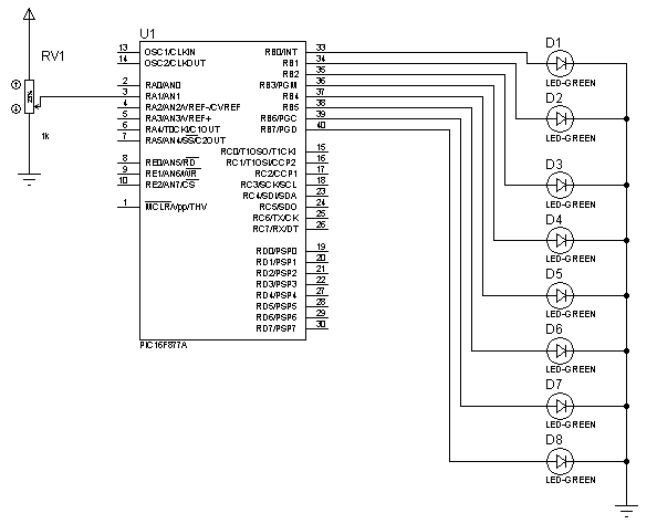

Nandika
Posts: 247
Location: Galle-Sri Lanka
Re: Help My Project(12CH LED Driver)??
Post by Nandika » Sun May 20, 2012 1:31 pm
Hi Friends,
I created 8 LED flasher with speed controlling.I used VR to change speed.
I have coding small ADC Example.It work 90% correctly.
But,When i change the VR,in two end of VR LED get lowest speed.(till analog input pin[RA2] goes +5V and GND)
It's speed is not monotony.(I used VR for "POT-HG" Proteus component.Is it may be a reason for this? :idea: :?: )
Actually,What is the reason for this?
Coding
main.c
    #include <pic.h>
    #include "delay.h"
    #include "adc.h"
	main(){
	PORTC=0;
	TRISB=0;
	PORTB=0x01;
	DelayMs(2000);
		do{
			int sp=GetADCRes();
			if (PORTB==0x80){
				PORTB=0X01;
				DelayMs(sp);
			else{
				PORTB=PORTB*2;
				DelayMs(sp);
		}while(1);
adc.h
#include <pic.h>
#include "delay.h"
	int GetADCRes(){
		ADCON0=0b10001101;//Conversion speed=Fosc/32,Input channel=channel1
		ADCON1=0b10000000;//Left jestify format,alls are analog channels
		return ((1800/255)*ADRESL)+200;//min speed=2000mS,max speed=200mS,therefore [(2000-200)/255}]*ADRESL
Circuit
Proteus Design File
circuit.zip
(14.76 KiB) Downloaded 731 times
Thanks All :)
