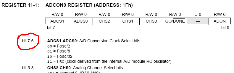

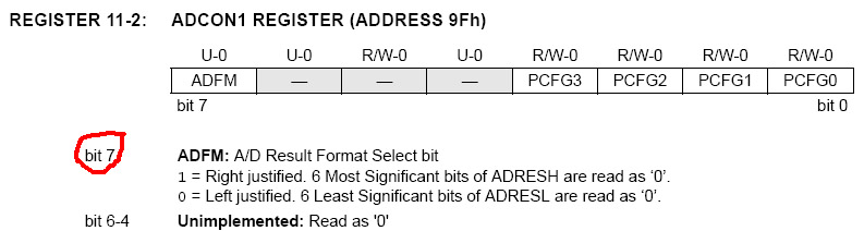

Thanks ZevenZero,SemiconductorCat and others,
I have problems about ADC unit of PIC16F877A.
What are ADCON0 bit6,7?please,explain me?
And,this
what is this result formats?
And,
This code work well. :)

I want to change analog input channel.i dcded like this,
But,No change..
I connected variable resistor to channel2.turn off all LED. :( :(
I connected it again to channel1,it work well.(PROTEUS give some warning )
int temp_res;
void main() {
//"A/D Conversion Clock Select bits"?? -->bit7-6=00
//Enable channel 2 -->bit5-3=010
//A/D Conversion Status bit -->bit2=1
//Nothing care-->bit1=0
//A/D On bit-->bit0=0
//binary value od ADCON0=00010100 = hex value=14
  ADCON0=0x14;
//"Right justified result format"??? enable -->bit7=1
//set all PORTA channel as analog input -->bit0-bit3=0000
//binary value of ADCON1 = 10000000 = hex value=80
  ADCON1=0x80;
  TRISA = 0xff;                 //PORTA INPUT
  TRISB = 0x00;                 //PORTB OUTPUT
  TRISC=0X00;                   //PORTC OUTPUT
  do {
    temp_res = ADC_Read(0);   // Get 10-bit results of AD conversion
    PORTB = temp_res;         // Send lower 8 bits to PORTB
    PORTC = temp_res >> 8;    // Send 2 most significant bits to RC1, RC0
  } while(1);
please,tell me about analog channel changing.

There are only 4 registers that are related to the ADC unit.
refer to this: http://www.mikroe.com/eng/chapters/view ... g-modules/
