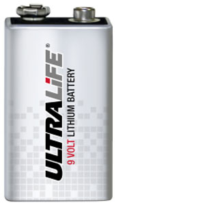

The 9v battery that I know is this.
If you are looking for electronic experiments, why don't you go for 6V or even 12V. Both voltages support 7805 standard 5V regulator directly. Both 6V and 12V are very common and cheap.
Also, if you want 9v, you could use a 12V battery with a 7809 regulator.
