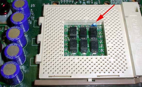

There is another point that came to my mind. It can be the thermal sensor which is malfunctioning after cleaning. Brush the CPU area of motherboard carefully again and see whether it improves. Note that the sensor is usually placed in-between the CPU socket as in the image (the look of the sensor can be different than the one in the picture).

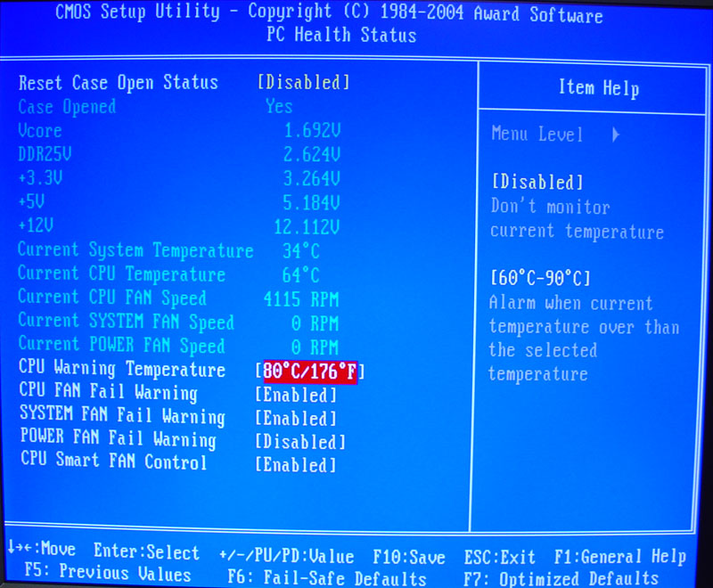

If you have tried everything above and you don't have a way to find thermal grease (=paste), adjust the "CPU warning Temperature" setting to 80C. Boot to Windows and see how the system behaves. If everything seems normal and steady, you can continue as that. If the system gets stuck, then you need to switch off the unit. Revert back to 70C and apply thermal grease to your heat-sink or replace with a new heat-sink.

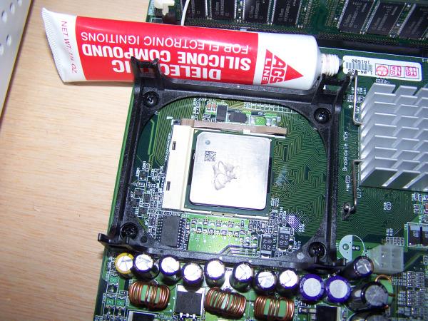

You can use Dielectric Silicone instead of Thermal grease. This is know to be an alternative for thermal grease whenever thermal grease is not available.
This is available in auto-shops (or spare parts shops). Try hardware shops as well.

i saw this one BIOS that is my pc's temparature is increasing upto 84c. What can you say for this? At the first time when this error come i was workin on my pc. When this was happening only the warning beep but system worked well.
