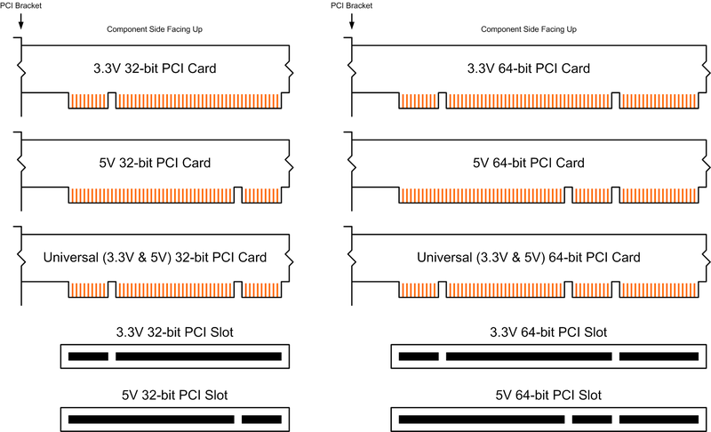

Typical PCI cards present either one or two key notches, depending on their signaling voltage. Cards requiring 3.3 volts have a notch 56.21 mm from the front of the card (where the external connectors are) while those requiring 5 volts have a notch 104.47 mm from the front of the card. So called "Universal cards" have both key notches and can accept both types of signal.
So as long as your card fits the port, it is perfectly okay.

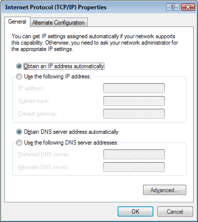

You need to check your IP address settings. Mostly the instructions are given in router's manual on how to set the IP addresses to work with the router. The most common setting is "Obtain an IP address automatically" and "Obtain DNS server address automatically" as in following image.

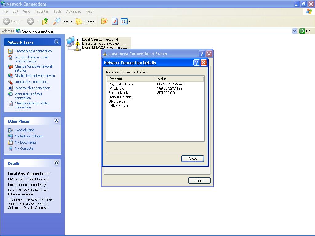

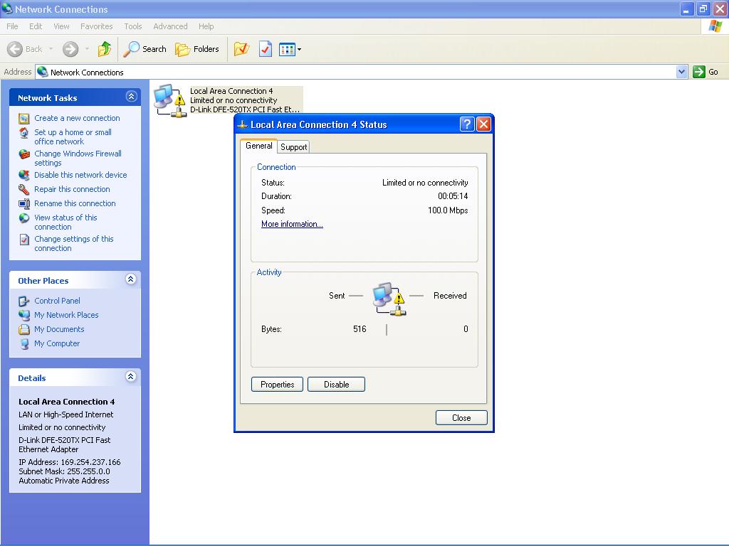

Post by Chamith119 » Wed Aug 11, 2010 10:29 pm
Hi
bought a new D-link card & installed perfectly, still it doesn't work, I've attached couple pf pictures, pls go thru them, there you find that subnet mask is 255.255.0.0, but it should be 255.255.255 (picture1)
also i noticed that there's no default gateway as well (picture2)
what can i do for this, pls advice, this is a headache for me now

On network status window (your first image) click on properties.
You will get a list of services allocated to the network interface.
Click on Internet Protocol (TCP/IP) and click on Properties button.
You can try two settings here.
Option 1:
As in my previous post, put ticks to "Obtain IP address automatically" and "Obtain DNS server address automatically".
Restart your router. After about 30 seconds, get network status again and see whether you are assigned with a new IP.
Even after 30 seconds, if your network card is waiting for a IP, then we need to manually set the IP/DNS (option 2).
NOTE: Usually DHCP server is enabled in the router. If this is not disabled then Option 1 should work.
