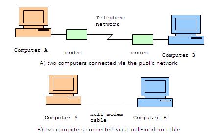

Here are two computers connected in different ways. The first uses two modems and the public telephone system, while the second eliminates both the modems and the telephone network.

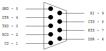

Serial communication is a heart quite a simple idea. There are three pins that are important. Data is transmitted over one pin (Transmit Data or TXD for short) and received over another pin (Receive Data or RXD). The data is sent sequentially as a series of on-off pulses down the wire, so a byte will take eight bits or pulses to transmit. In fact, there are one or two other bits needed as well for synchronisation and error checking, but that’s the basics. The third wire that’s needed is the Ground wire (GND) – these are electrical signals and so need a return path. While you can get away with just three wires, it’s often useful to have other control signals to make things easier for the software. There are six other signals: Ring Indicator (RI) is set by a modem when it detects an incoming call. Carrier Detect (CD) is again set by the modem when it detects another modem as the originator of the incoming call. For a null-modem, RI and CD can are ignored.
This leaves four other signals which come in pairs. Request To Send (RTS) and Clear To Send (CTS) are used by the PC to signal that it is ready to write or read data respectively. Data Terminal Ready (DTR) and Data Set Ready (DSR) do a similar sort of job (there are actually finer details of what these signals should be used for – but that needn’t bother us here). So for our null-modem purposes there are three pairs of wires – and these need to be ‘crossed over’ for the two ports to communicate. That is, the RCD pin of one port must be connected to the TXD pin of the second and so on. This means that when COM1 transmits data (on TXD) COM2 will receive data on RCD. The complete wiring between the two connectors looks like:
