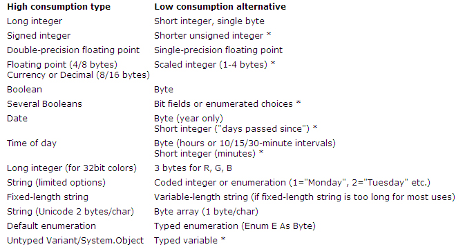

Type your variables properly
Use the smallest data type that covers the use. Using long integers or floating point to store values 0..255 is an overkill. You can sometimes come by with an short integer instead of a string. Some environments (such as .NET) also allow typed enumerations. A byte is usually more than enough to store the values of an Enum.
* = Notes below
Shorter unsigned integer
Suppose you need to store values in the range 0..65535. A signed 2-byte short integer will not be enough. An unsigned short integer, on the other hand, can fit nicely. Some languages don't offer unsigned data types, unfortunately. As an example, Visual Basic supports unsigned integers since version 2005. So, what previously consumed a longer integer, may now fit in an unsigned shorter integer.
Scaled integer
A scaled integer means you use a regular integer to store decimal values. When you need the "real" value, divide the number by a correction factor. For example, if you need to store a price in the range $0.00 to $327.67, you can store it in a 2-byte short integer as 0 to 32767. You just divide it by 100 when you need the dollar value. — The Currency and Decimal data types (in VB and .NET) are implemented internally as scaled integers. The problem with them is that they consumer more memory than what is required for small values. To save memory, store the values in regular integers and do the scaling by yourself.
Bit fields or enumerated choices
A Boolean value regularly consumes 2 bytes to represent a single bit (False or True). You can combine up to 8 Boolean values into a single byte by using Boolean operators And and Or (& and |). You can also combine several Booleans to a single enumeration. Example: Suppose an order system with two Boolean fields: Shipped (True/False) and Invoiced (True/False). You can combine them as 4 status codes: ShippedInvoiced, ShippedNotInvoiced, NotShippedInvoiced and NotShippedNotInvoiced. Instead of 4 bytes for 2 Booleans you store just 1 byte.
Dates
For dates you don't usually need the usual 8 bytes (or 10 bytes required by "yyyy-mm-dd"). If you only need the year, you can store it in a single byte. Say 0..255 means 2000..2255 or 1900..2155, more than enough for many purposes. If you need the full date, you can well calculate the "days passed since base date". You can fit 65536 days in 2 bytes, which is 179 years, quite enough for many uses. Just choose a sensible base date. For historical dates before the base date, you can even use negative "days passed".
Time of the day
Minutes are often enough precision instead of the regular 8 bytes of date data types (or 13 bytes for "hh:mm:ss a.m."). There are 1440 minutes/day, which will happily fit in a 2-byte short integer. If you can do with 10-minute precision or less, you can fit these time intervals in 1 byte.
Untyped data
Some languages have an "all-in-one" data type, such as Variant in Visual Basic or System.Object in .NET. This data type is usually the worst choice what comes to memory requirements.
Choosing the correct data type is especially important with arrays and user-defined data types. The savings with regular variables are much smaller.
