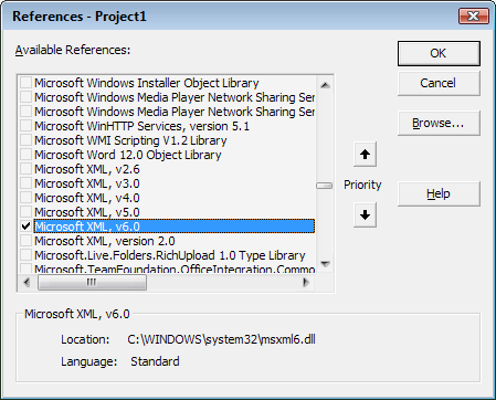

Okay...Here is one short method. Wininet produces problems behind proxies and firewalls. MS XML can always do the trick with few lines of code. You can use GET and POST as you want. Note that Text1 is a Text Box.
	Dim req As XMLHTTP
	Set req = New XMLHTTP
	req.open "GET", "https://robot.lk/index.php", False
	req.send ""
	Text1.Text = req.responseText
You will have to add the following DLL from References.
Thank you very much neo for fast a small code. :biggrin:
