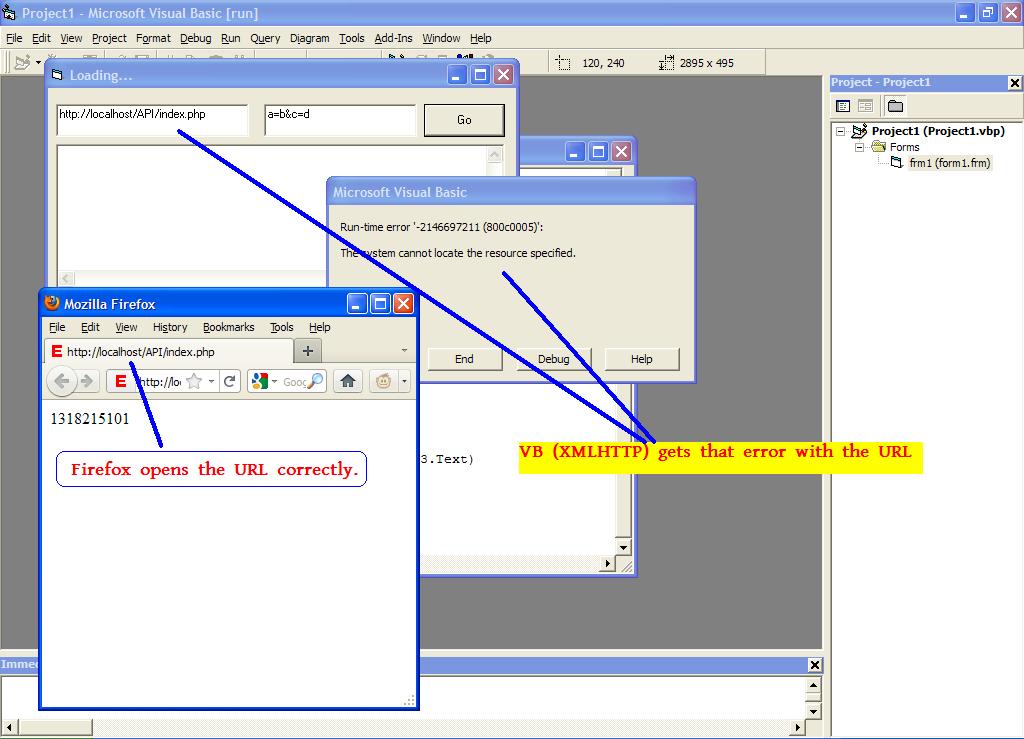

Re: How to scrap text from internet in VB
Post by Rksk » Mon Oct 10, 2011 8:34 am
vb errror2.jpg (94.97 KiB) Viewed 30889 times
Post by Neo » Mon Oct 10, 2011 3:11 pm
Worked on the first run!
I can't guess anything without seeing your code.

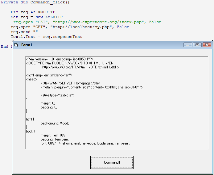

Post by Rksk » Wed Oct 12, 2011 12:26 pm
Yes, I found the error.
The computer must be connected to the internet to call localhost too.
It doesn't work, Without an internet connection.
I tried with Xampp. I don't know where is the problem.
Post by Neo » Wed Oct 12, 2011 12:45 pm
Try WAMP. It might work without an internet connection.
