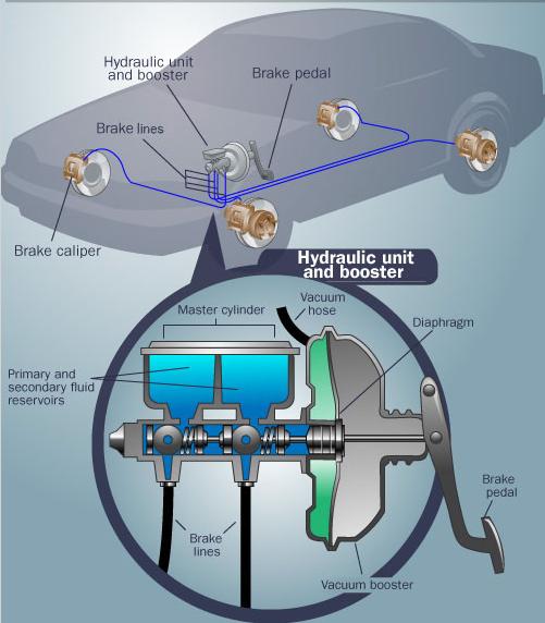

Power Brake Diagram
Now let's put the parts together to see how power brakes work as a whole. This diagram provides both a closeup view and an example of where the brakes are located in your vehicle.
