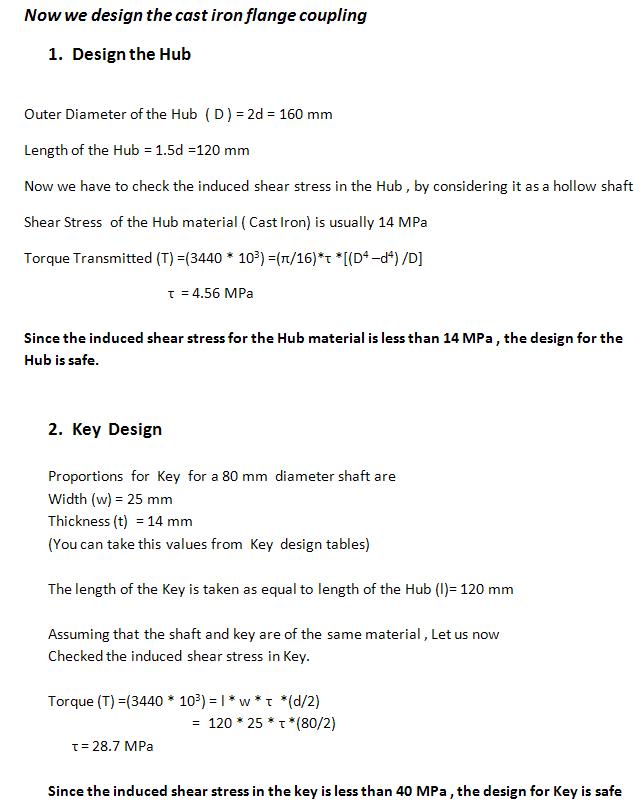

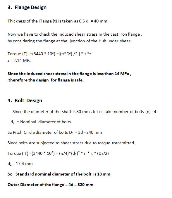

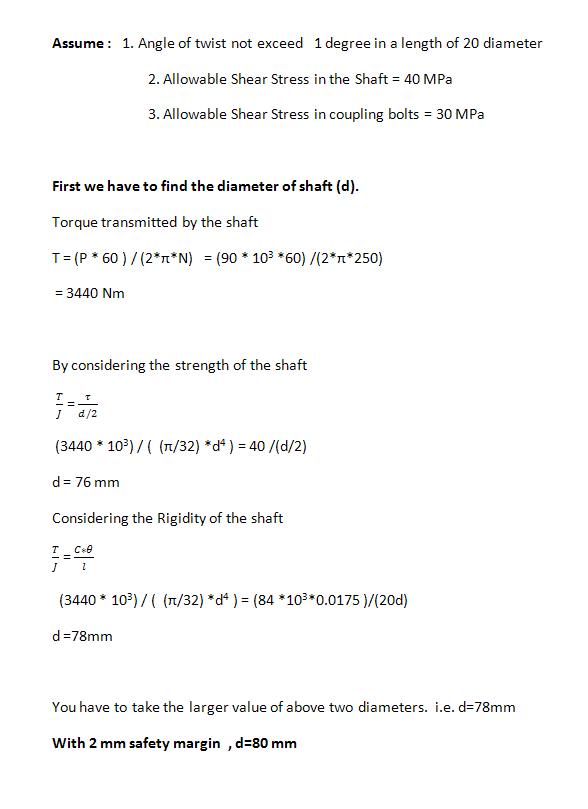

Hi All ,
I want to design a cast iron flange coupling to transmit power from a electric motor to a ball mill.
rated power output of motor is 90 KW at 250 rpm. Both motor and ball mill shafts have made outof mild steel.
Can any body tell me how to design this please ?
basically I want folowing
1. Hub design
2. Key design
3. Flange design
4. bolts design

Dear Friend ,
Here is the detail design for Flange Coupling Step by step. If you have any problem with this solution , just drop it in
robot.lk. As robot.lk team , we are always with you for solving your technical problems.
Good Luck !

Dear Magneto ,
Thanks for your very clear and step by step answer. I got the stuff. I was searching a solution for this problem in the Internet for last few days and unable to find any good one.
