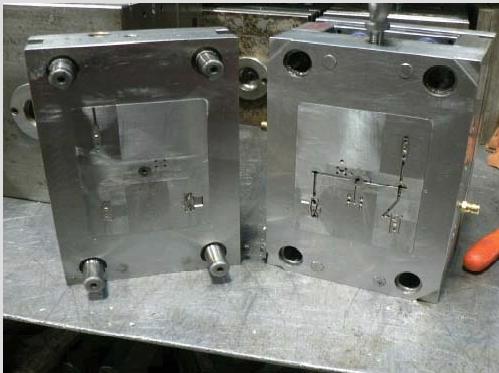

How are Injection Molded Plastic Parts Made?
Injection molding generally follows a standard process:
1. The mold is set up for molding operations. A mold generally has two halves that are clamped or pressed together for the molding process.
2. Granular or powdered plastic material is fed into a screw plunger. The plunger is heated, and melts the plastic as it travels through the plunger. The screw plunger also helps to mix different plastics together, or different base components of a thermoset plastic together to create a homogeneous blend.
3. The plunger forces the molten plastic through a nozzle into the mold through gates.
4. The plastic is allowed to cool within the mold. The mold can be air cooled, or be artificially cooled with water or other fluids.
5. The mold is opened, and ejector pins push the part out of the mold. Ejector pin marks are often evident on injection molded parts.
6.Excess material that cooled in the gates or around the parting line of the mold is trimmed away from the part, and further finishing is performed as needed.
