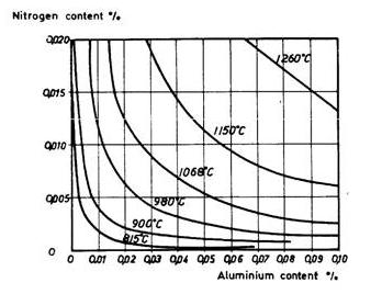

Aluminum is the most powerful, very frequently used deoxidizing and also detriding agent. It also has an extremely favorable effect on resistance to ageing. Small additions assist fine-grained structure. In nitriding steels, it is usually an alloying element and forms very hard nitrides with nitrogen. Since it increases scaling resistance, it is frequently added to alloy ferritic heat resistant steels. With unalloyed carbon steels, scaling resistance can be promoted by introduction of aluminum into the surface. Aluminum very sharply restricts the gamma phase. Aluminum is also an alloying element in iron-nickel-cobalt-aluminum permanent magnet alloys, since it greatly increases coercive field intensity. Fig. 1 below shows Solubility of AI-N in austenite at temperatures below 1260C.
Fig. 1: Solubility of AI-N in austenite at temperatures below 1260C (after Bain)
