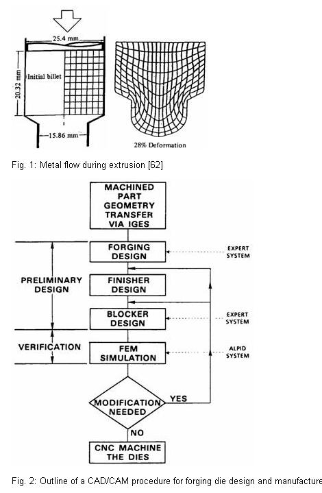

A small-strain 2-D (axis-symmetric) elastic-plastic finite-element analysis was used to study this process. The material (commercially-pure aluminum) was assumed to be extruded slowly and under isothermal conditions, with the yield stress depending only upon strain.
In Fig. 1, metal flow pattern was simulated with the FEM, during which beta-stiffness friction model was used, with a value of friction factor m = 0.7 employed to correspond with unlubricated contact between the billet and the container and punch.
As illustrated in Fig. 2, the ultimate process and die design in forging requires non-isothermal flow simulation via 2D and 3D FEM techniques. Thus, dies can be designed better and the need for experimentation is reduced.
