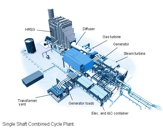

The combined-cycle system includes single-shaft and multi-shaft configurations. The single-shaft system consists of one gas turbine, one steam turbine, one generator and one Heat Recovery Steam Generator (HRSG), with the gas turbine and steam turbine coupled to the single generator in a tandem arrangement on a single shaft. The key advantage of this single-shaft arrangement is its operating simplicity with higher reliability than multi-shaft blocks. Further operational flexibility is provided with a steam turbine which can be disconnected, using an SSS Clutch, for start up or for simple cycle operation of the gas turbine.

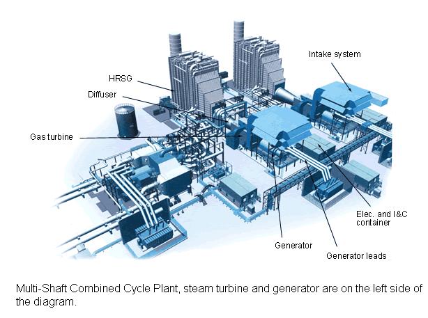

Multi-shaft systems have one or more gas turbine-generators and HRSGs that supply steam through a common header to a separate single steam turbine-generator. In terms of overall investment a multi-shaft system is about 5% higher in costs.
