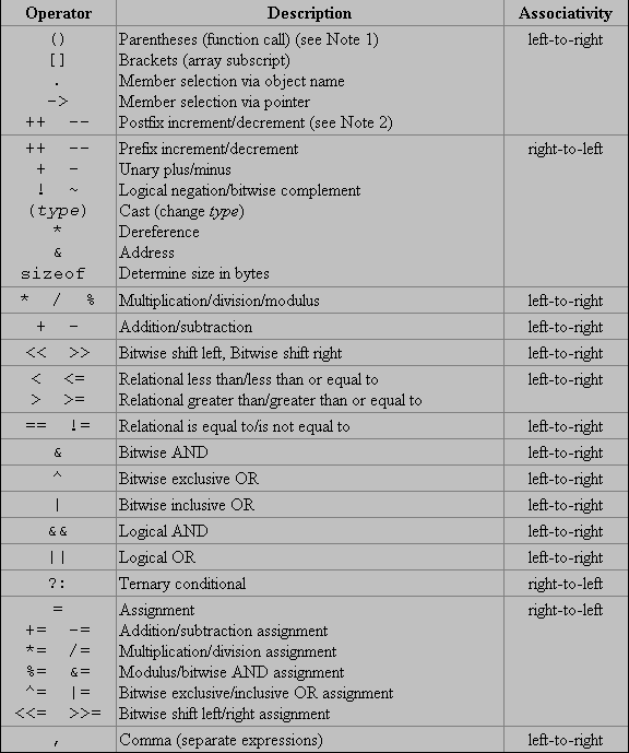

Note 1:
Parentheses are also used to group expressions to force a different order of evaluation; such parenthetical expressions can be nested and are evaluated from inner to outer
Note 2:
Postfix increment/decrement have high precedence, but the actual increment or decrement of the operand is delayed (to be accomplished sometime before the statement completes execution). So in the statement y = x * z++; the current value of z is used to evaluate the expression (i.e., z++ evaluates to z) and z only incremented after all else is done.
