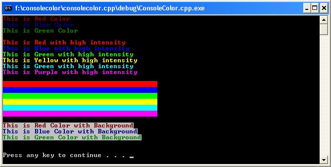

Hi
The code below will demonstrate how to print text with colors in a console. :)
Note : This will run only in windows.
major colors are
FOREGROUND_RED,FOREGROUND_BLUE,FOREGROUND_GREEN
BACKGROUND_BLUE,BACKGROUND_GREEN and BACKGROUND_RED
you can create new colors by performing the bit-wise operations on these colors
please note that the MSDOS is not based on RGB color scheme. So it
only supports for 6 colors (as far as I know).
FOREGROUND_INTENSITY - this will increase the intensity of the text in the DOS screen
BACKGROUND_INTENSITY - this will increase the intensity of the background color of the DOS screen
#include <windows.h>
#include <stdio.h>
HANDLE hConsole;
CONSOLE_SCREEN_BUFFER_INFO ScreenBufInfo;
WORD colorWhite =BACKGROUND_BLUE|BACKGROUND_GREEN|BACKGROUND_RED;
//These constants are used to draw the lines
char line[] = {
						0xDB,0xDB,0xDB,0xDB,0xDB,0xDB,0xDB,0xDB,0xDB,0xDB,
						0xDB,0xDB,0xDB,0xDB,0xDB,0xDB,0xDB,0xDB,0xDB,0x0A
void cPrintf(const char* szValue,WORD color);
int main()
	cPrintf("This is Red Color\n",FOREGROUND_RED);
	cPrintf("This is Blue Color\n",FOREGROUND_BLUE);
	cPrintf("This is Green Color\n",FOREGROUND_GREEN);
	printf("\n");
	cPrintf("This is Red with high intensity\n",FOREGROUND_INTENSITY|FOREGROUND_RED);
	cPrintf("This is Blue with high intensity\n",FOREGROUND_INTENSITY|FOREGROUND_BLUE);
	cPrintf("This is Green with high intensity\n",FOREGROUND_INTENSITY|FOREGROUND_GREEN);
	cPrintf("This is Yellow with high intensity\n",FOREGROUND_INTENSITY|FOREGROUND_GREEN|FOREGROUND_RED);
	cPrintf("This is Green with high intensity\n",FOREGROUND_INTENSITY|FOREGROUND_GREEN|FOREGROUND_BLUE);
	cPrintf("This is Purple with high intensity\n",FOREGROUND_INTENSITY|FOREGROUND_BLUE|FOREGROUND_RED);
	printf("\n");
	cPrintf(line,FOREGROUND_INTENSITY|FOREGROUND_RED);
	cPrintf(line,FOREGROUND_INTENSITY|FOREGROUND_BLUE);
	cPrintf(line,FOREGROUND_INTENSITY|FOREGROUND_GREEN);
	cPrintf(line,FOREGROUND_INTENSITY|FOREGROUND_GREEN|FOREGROUND_RED);
	cPrintf(line,FOREGROUND_INTENSITY|FOREGROUND_GREEN|FOREGROUND_BLUE);
	cPrintf(line,FOREGROUND_INTENSITY|FOREGROUND_BLUE|FOREGROUND_RED);
	printf("\n");
	cPrintf("This is Red Color with Background\n",FOREGROUND_RED|colorWhite);
	cPrintf("This is Blue Color with Background\n",FOREGROUND_BLUE|colorWhite);
	cPrintf("This is Green Color with Background\n",FOREGROUND_GREEN|colorWhite);
	printf("\n\n");
	system("pause");
	return 0;
	// free the memeory for the struct
	ZeroMemory(&ScreenBufInfo,sizeof(ScreenBufInfo));
	//geting the handle of the console
	hConsole = GetStdHandle(STD_OUTPUT_HANDLE);
	// saving the original values of the console buffer
	GetConsoleScreenBufferInfo(hConsole,&ScreenBufInfo);
	//setting the new color
	SetConsoleTextAttribute(hConsole,color);
	//printing the value with new color
	printf(szValue);
	// resting the color to its normal values
	SetConsoleTextAttribute(hConsole,ScreenBufInfo.wAttributes);
