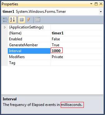

You can create a timer at design-time by dragging and dropping a Timer component from Toolbox to a Form. After that, you can use F4 or right click Properties menu to set a Timer properties as shown in Figure 1. As you can see in Figure 1, the Enabled property is false and Interval is set to 1000 milliseconds (1 second).
When you assign 1000 msec as in the picture, this function is called every 1 second using a different thread without disturbing the current execution point of your program.
Think you are in a single core environment (It is easy to understand in this way). Say that you are running a function and you are in the middle of it... And 1 second is gone after the last call to Timer_tick... Then what happen is, the execution of the current function will be kept on hold and the CPU will start executing Timer_tick. After completion, the CPU will continue to execute the function which is on hold.
