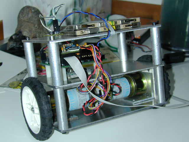

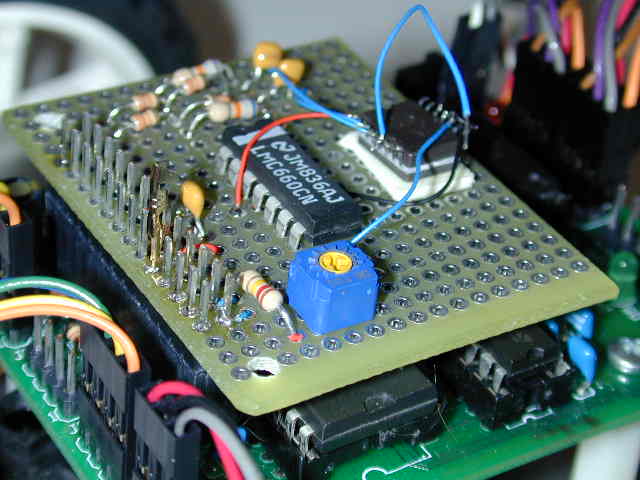

Gyrobot is based upon the AVR Robot Controller board (ARC 1.0) which is based upon the Atmel at90s8535 processor. The ARC 1.0 board has everything needed to connect to sensors and drive the wheels with minimal bread boarding. The additional boards, below, mainly bring out the signals from the expansion headers to the switches, sensors and user LCD interface.

The solution to drift is to use an absolute tilt device. One such device is the Analog Devices ADXL2002 accelerometer. These devices are very sensitive to acceleration and only give an accurate indication of down (acceleration due to gravity) when the rest of the platform is stable. The basic idea is to use the tilt sensor to adjust the integrated rate gyro data when the system is at equilibrium (i.e. not rotating or accelerating relative to the ground). In the picture, below, the tilt sensor is the "squashed bug" (upside down chip) on the proto board.

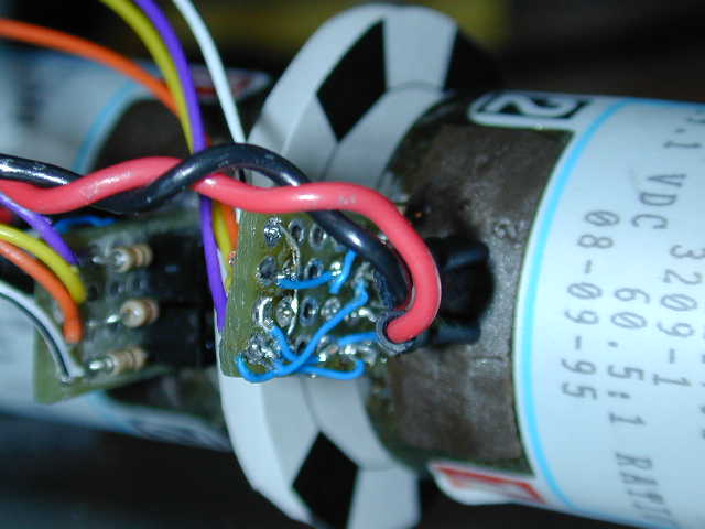

The velocity, or position, of the base, relative to the ground is determined with Quadrature encoders on the left and right wheels. The encoders have two adjacent sensors that detect the boundaries between the black and white stripes on the encoder disks (below). The encoders both count the number of boundaries and keep track of which value came first (black or white) and thus the direction of rotation. This is used to keep an absolute value of wheel position. The wheel position can be used to direct the robot to a particular place in XY coordinates through the use of Odometry.
Wheel Encoder.jpg (35.66 KiB) Viewed 6414 times

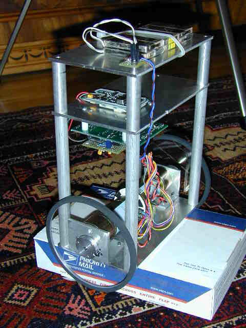

Tall gyrobot.jpg (60.4 KiB) Viewed 6414 times
5/14/2002 I modified the base to move the mass away from the wheels and made some larger wheels. The large the moment of inertia (the farther away the mass of the robot is from the wheels) the easier it is to balance. Check this out by trying to balance a broom on your hand. Then turn the broom upside down and try again. Which is easier?
