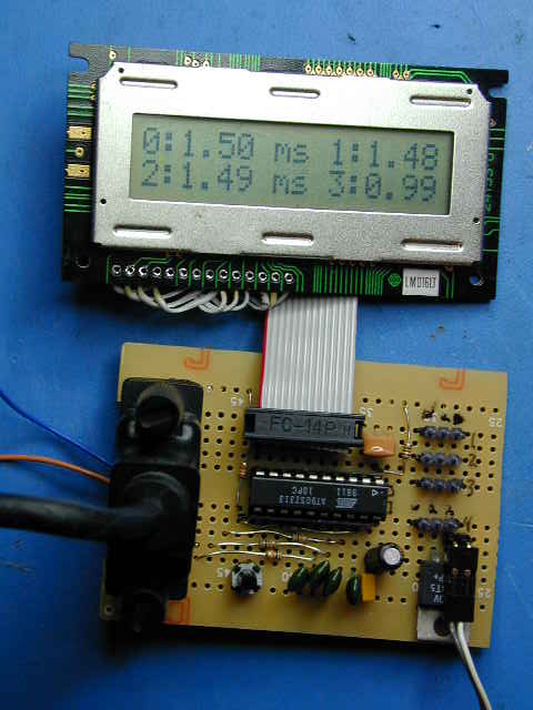

The techniques presented here are easily capable of 8 bits of resolution (256). The display, below, was truncated to 100 discrete values primarily to fit everything on the screen of a 2x16 LCD display. If you have a 2x20 or 2x24 character display, removing a comment from the display code will restore the fourth digit.

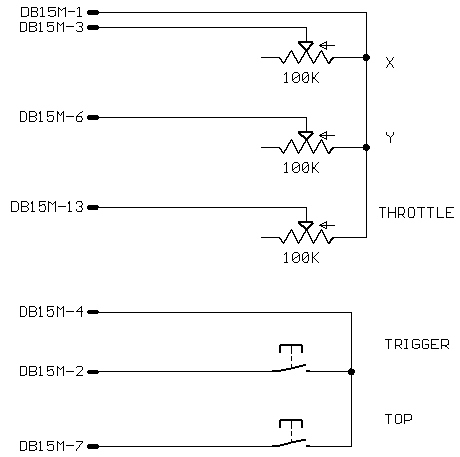

The CH-Products Joystick, is a standard in analogue joysticks. It comes with a joystick with two potentiometers, one for the X and one for the Y axis. A third potentiometer is connected to a throttle wheel. In addition to the analogue signals, the joystick has two buttons: a trigger and a top button. The joystick interfaces with the Game Port with a 15 pin male sub-D connector. The analogue joystick no longer seems supported at CH, but you can call the factory to purchase them.
You can read everything you need to know about Analogue Joysticks at ePanorama.
Measuring the position
Each potentiometer is a 100k linear taper potentiometer connected to +5 source. Switches are connected to a ground terminal. The algorithm for measure the resistance starts with a completely discharged capacitor. The capacitor is kept discharged by driving the output pin of the processor to ground (0). Then, the I/O pin is switched to an input and the capacitor is allowed to charge towards VCC through the joystick resistor. At a particular threshold voltage, .45 * VCC, the input pin will detect that a '1' is present. The processor simply spins in a loop, incrementing a counter, until it reads a '1' at that port. The software then switches the I/O pin to an output with a value of 0, discharging the capacitor. The I/O pin is left as an output pin, with a value of 0 until the next measurement.

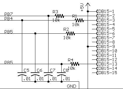

Shown above is the schematic of Joystick interface. The series 10k resistors set the minimum charge time and protect the CPU output drivers from the zero ohm position of the potentiometer. Note: Pin 2 is the trigger switch. When open, the capacitor will never charge up. The software for timing the R-C charge time has a timeout. So the switch either shows maximum time or minimum time and nothing in between.

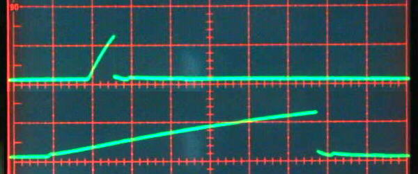

RC Timing Trace.jpg (29.38 KiB) Viewed 4521 times
Minimum and Maximum RC time (.1 ms and 2v/div)
The above photo shows the minimum and maximum charge times for the capacitor on this project.

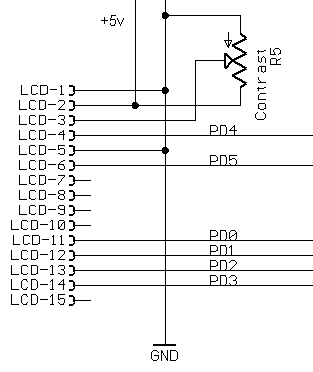

The schematic the connection between the CPU and the LCD. There is a small potentiometer to adjust the contrast of the display. You can tie the contrast pin (3) to ground and usually the contrast is sufficient. That is what I did on the prototype. The interface to the LCD is defined in the file lcd.inc in the source code. You need to specify the port that the data is on and whether it is high or low nibble. You also need to specify the port and bits that the control lines are assigned.

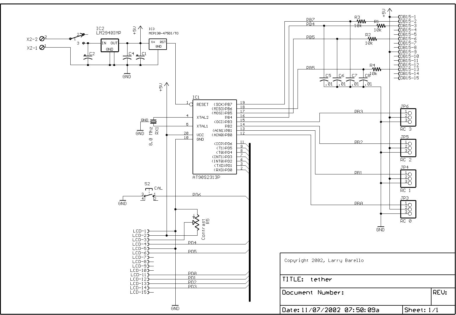

Schematic
Note, the schematic needs some changes. The current choice of pins for measuring the R-C timing (PB4-7) prevents In-Circuit-Programming (ISP) and the chip has to be popped into a separate socket for programming. This is simple enough: swap the R-C timing for the R/C pulse output and make the appropriate changes to the file hardware.h.
