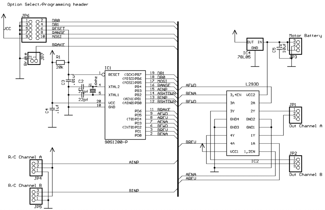

A common problem for hobby robotics is controlling the drive level to a motor. Often hacked R/C servo's are used, but they typically have poor control range. Many micro-controllers don't have built in PWM or the PWM is very slow and makes for lots of motor buzz. This paper describes an AVR chip and software that converts two easily formed R/C pulse signals (often directly supported by inexpensive controllers like the Basic Stamp) and converts them into a PWM signal suitable for driving small motors.
This AVR application and the reference board design is very much like the hobby shop ESC (Electronic Speed Controller) for Electric R/C cars, etc. The value of this AVR software application is that one can interface the output signals of the AVR chip to a wide variety of H-Bridge driver chips with a current capacity from 600ma to 5+ amps. Or, it could drive a discrete FET bridge for even higher capacities.

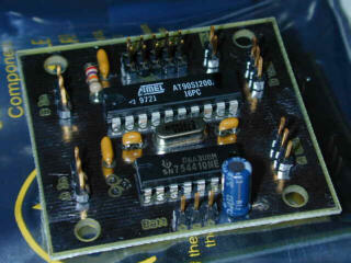

I created a reference design board for the chip that uses an sn754410 chip as the output driver. Any H-Bridge motor driver chip or circuit could be driven by this design (within the limits of the converter chip output drive). The TI chip is an improved drop-in replacement for the standard L293D chip. The TI chip has a 1 Amp output capacity per channel with a maximum motor supply voltage of 35v.
The following users guide describes how the reference board works when loaded with this version.

The software is written for the GNU avr-gcc assembler.
The schematic and circuit board were designed using the Eagle cad package.
RC Speed Control brd.gif (80.8 KiB) Viewed 5065 times
The following attached file contains the software, makefile, schematic and printed circuit board design.
