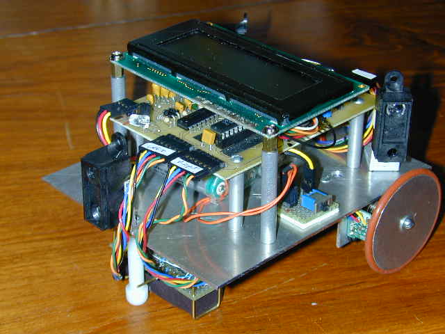

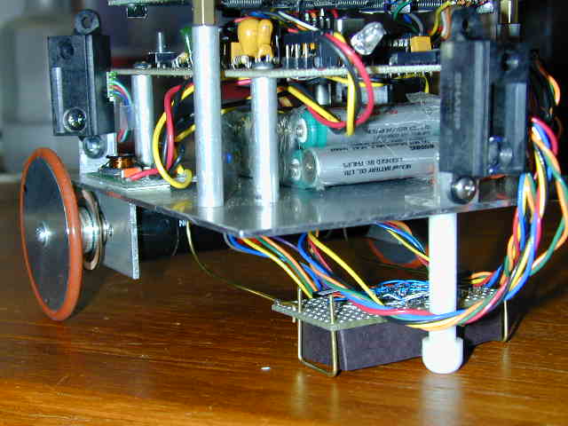

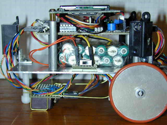

Here are front and rear quarter views along with a side view that shows the home made 12 cell battery pack. The wheels are 2" in diameter and the overall length is about 5 1/2". The Sharp GP2DO2 sensors are just mounted and not wired in yet. I'll simply lift the code from Dilbert when it comes time to use them.

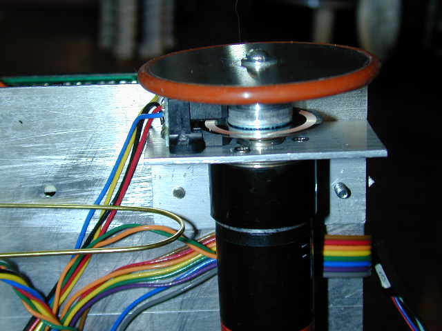

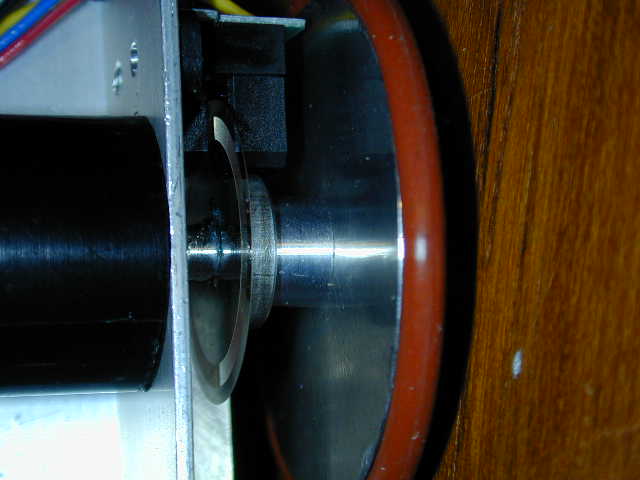

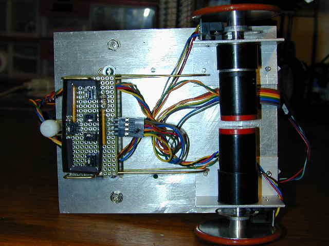

Various views of the motor mounts, the commercial encoder wheels (400 lines, 1" in diameter!) and the home made wheels and o-ring tires.

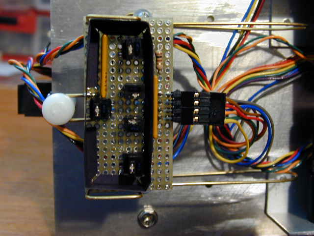

Close up views of the floor sensor assembly and how it is mounted to the chassis. The wire spacers, that the sensor rides upon, are hand bent 1/16" brass rod material from a hobby shop.

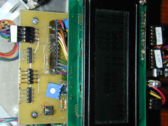

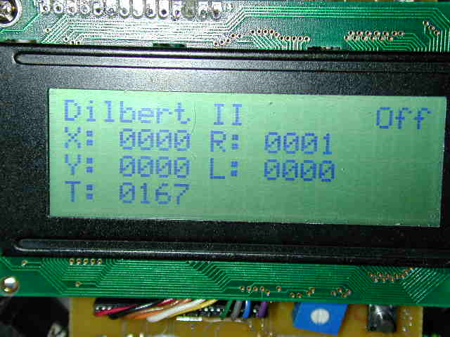

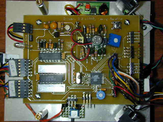

Several views of the user interface and the controller board. The LCD is displaying the absolute X, Y and Theta position of the robot using floating point odometry in the motor control code. The "Off" in the corner is the status of the microphone audio detect circuitry. The small square chip to the lower right on the controller is the actual CPU with all the memory and I/O. The shiny square is an attempt at a heat sink for the motor driver chip. The other two chips are the hex inverter, used for various functions, and the quad op-amp used for the audio detect circuit.

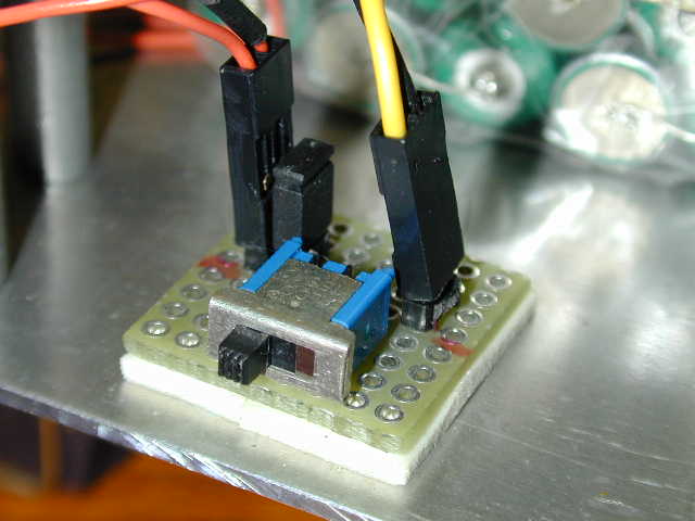

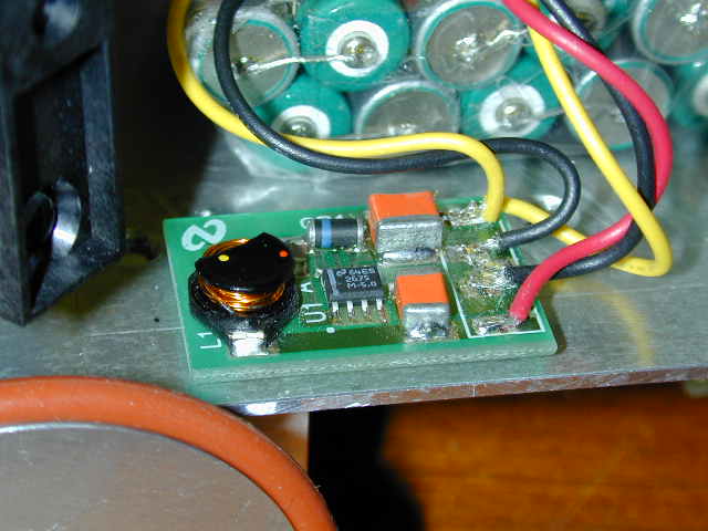

As you can see, the switcher power supply is very tiny. To simplify replacing batteries, and looking forward to dual battery packs for a 28v supply, I built a little switch module with headers for two batteries (one replaced with a jumper) and the switcher.
