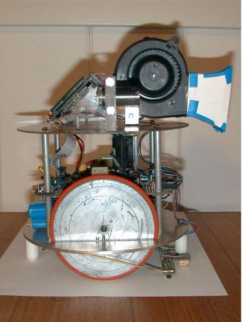

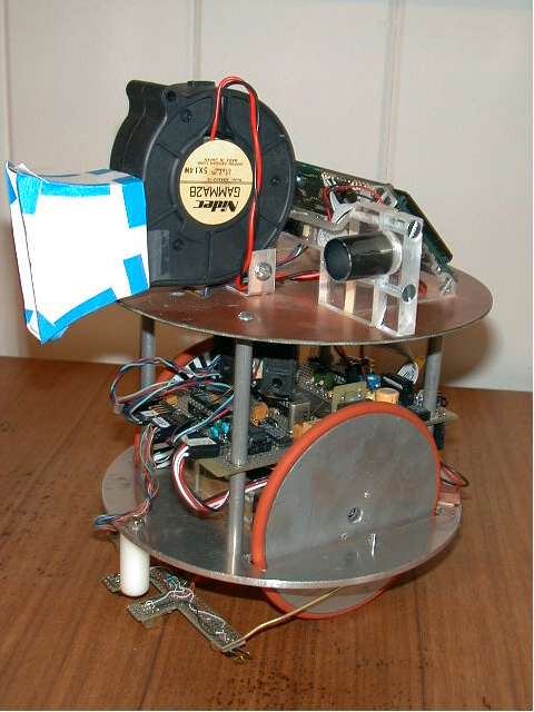

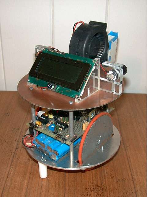

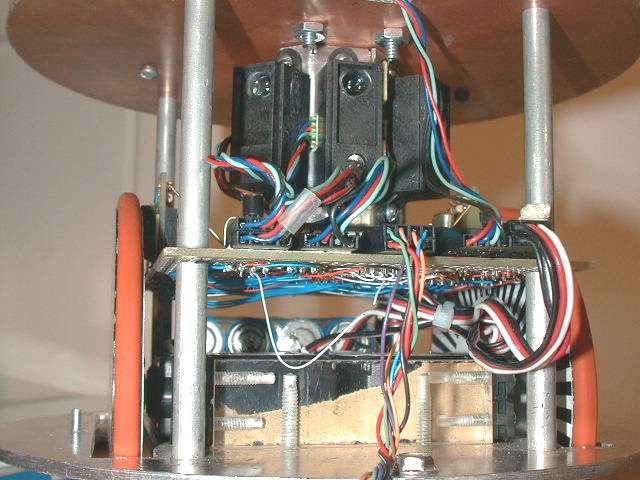

Here are three views of Dilbert. The paper horn was placed on the fan to direct the airflow in a more concentrated pattern and to cover a larger vertical distance.

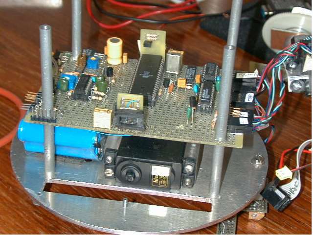

This view is with the top panel and the drive wheels removed. You can see the encoders and the Hitec 605BB servos. The aluminium plate was cut out on a band saw, turned on a lathe and the wheel slots cut with a jig saw.

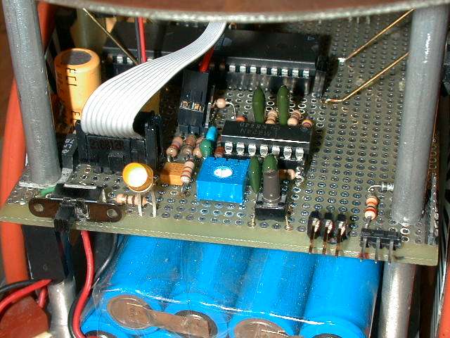

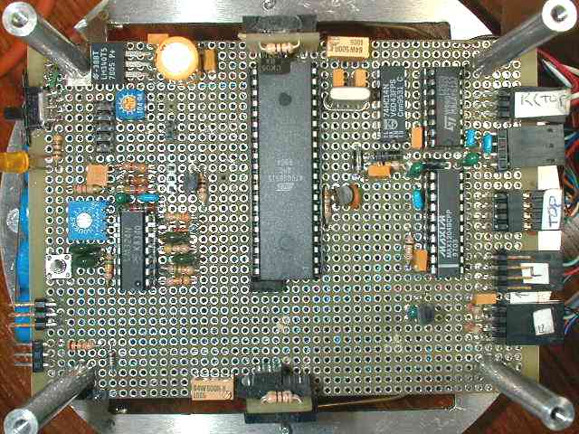

The L293 motor driver chip is at the far upper right. A hex inverter is next followed by the Atmel AT 90S8515 controller. The far left is the 5v regulator, conveniently located under a mounting post. Below the regulator is the LM324 used for the Audio Detect Circuit The connector next to it is for the LCD display The connectors on the upper right are for the Sharp proximity detectors, On the leftt are the SPI and serial interface headers.

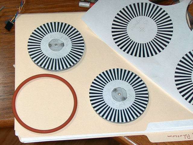

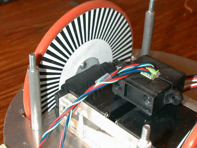

I crafted an encoder wheel using a drafting program, printed them out on my laser printer and glued them onto 4" disks of Plexiglas that served as the wheels. The wheels also have 4" silicon O-Rings as the tread.
The Hitec HS-605BB servos are stripped of electronics, the tab clipped to allow continuous rotation and have an 4" wheel (4" silicone rubber O ring) attached to the original control "horn" that came with the servo.

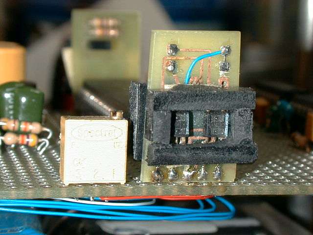

Dilbert has two Hamamatsu photo reflexive detectors set up 90 deg out of phase for quadrature detection. What this means is that when the white band of the encoder passes from left to right on the detector, first the left detector will go active, then the right one. The same pattern happens for the black band as well. The resulting waveform, if view on an oscilloscope, looks like two square waves 90 deg out of phase. By tracking which comes first the software can tell which direction the wheel is turning. The encoder has 45 segments, which gives the robot 180 clicks/revolution, or 2 deg, or 1/15" with a 4" wheel.

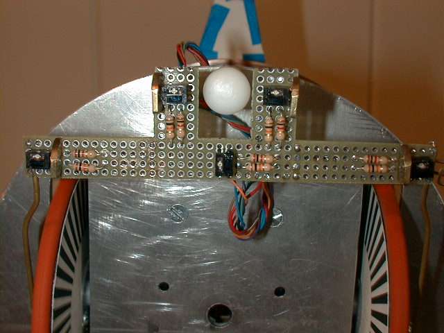

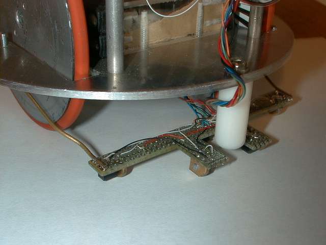

Here are two views of the floor sensor assembly. I used a an IR reflective photo sensor that I got from Digikey, part# QRD1114QT-ND. There are five sensors. Three are clustered close together for tracking a line. The outer two sensors are for gross line tracking and threshold detection. Dilbert uses threshold detection to align itself square to the opening of a room in the Fire Fighting Competition.
The Sharp GP2D02 sensors are mounted forward of center and vertically. The left and right sensors are also aimed forward at approximately a 45 degree angle. The sensors are also grounded to the copper ground plane that forms the upper surface of the robot. The 45 degree angle is an essential part of the wall following algorithm: the raw output is roughly correlated to the signal needed to turn the robot and keep it a particular distance from a followed surface.

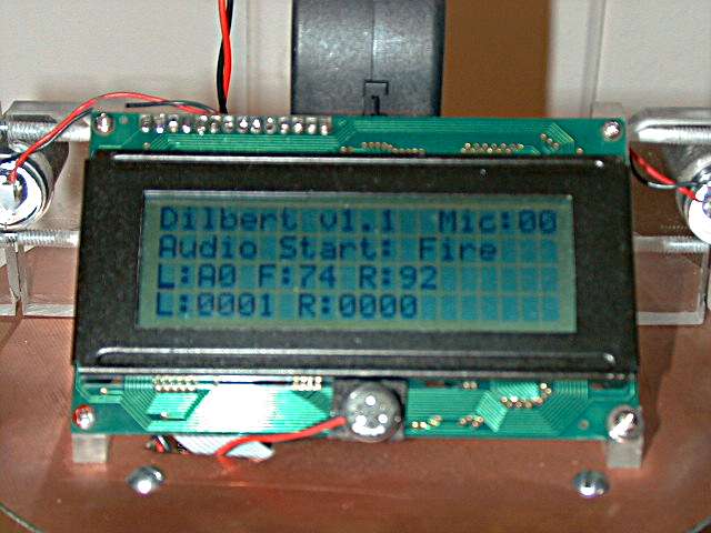

The user interface consists of an Microphone, a push button, an LED and an LCD display.
The push button has three possibilities: short, long and reset. These correspond to a push of less than a second, between 1 and 10 seconds and greater than 10 seconds, respectively. The short is used to cycle between menu items and the long is used to select within a menu. The reset, well, resets the robot.
There is an LED as well. It mainly winks to indicate that the basic program is running. It also goes on solid when a valid audio signal is detected by the microphone. The Audio signal is a Radio Shack piezo buzzer that is used to start and stop various programs within Dilbert.
