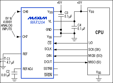

Figure 1, below, is from the MAXIM web site and shows the typical connection between a 3v processor and the MAX1204 chip. Since my robot has +5V logic (74HCXXX) I simply tied the logic level sense to the +5V supply.
10 bits is pretty high resolution. To avoid digital noise on the analogue signals, I added a separate +5V supply (78L05) devoted just to the ADC and the photodiodes used as inputs. The ground for all of the above was tied into one point where the power came into the regulator. With minimal bypass capacitors on the ADC inputs I easily get stable readings. The other five inputs, connected to Dilbert’s floor sensors, are not bypassed and are driven from the +5V logic supply and there is one bit of dither when reading them. Since I lop off the floors to 8 bits, it turns out not to be important. Still, one bit of dither from the Logic supply indicates to me that the separate analogue supply wasn’t really needed in my design.
