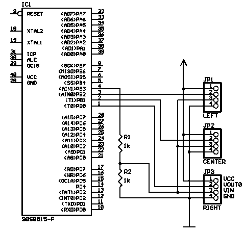

To conserve I/O ports on the Atmel 8515 AVR processor, I multiplexed the sensors by using one I/O bit to be the control line for all sensors and connecting the three return data lines to bits 0, 1 and 2 of an I/O port. The software initiates a reading by dropping the control line, then it polls the three data lines waiting for all three to become 1's (0x07 in my case), then it clocks the data into the CPU. Since the three sensors are connected to sequential bits of a port, the software simply rotate the bits through the carry bit and into their respective destination bytes.
Note, the Sharp sensors require 3v logic on the input pin,, hence R1 and R2.

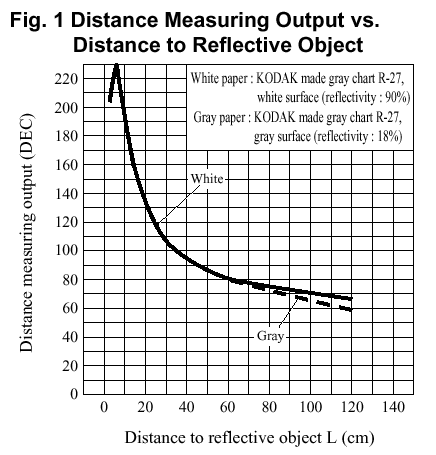

The sensors have an output curve that is the inverse of the distance of the target. The farther away the target, the lower the output value. The following chart is from the Sharp GP2D02 Data Sheet.
It turns out that the curve has a 1/X relationship. In fact, the formula D = Kg/(X-Ko), where X is the output of the sensor, can give very accurate values for distance. This calibration is easy to perform: it involves one division and one subtract. On Dilbert, the results are calculated in 10th of an inch and returned in a byte value, so the maximum distance that can be measured is ~25".
Since the calibration calculation only involves two constants, one can figure out what those are using two measurements from the unit. For details on how I got these formulas, see Derivation Of GP2D02 linearization formulas.
