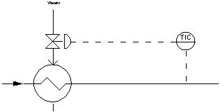

1. The Process

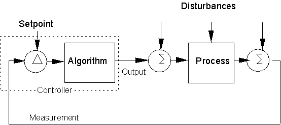

1.1 The Feedback Control Loop
The system measures the process, compares it to a setpoint, and then manipulates the output in the direction which should move the process toward the setpoint.

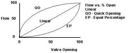

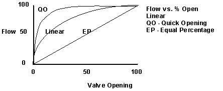

1.2 Valve Linearity
Valves are usually non-linear. That is, the flow through the valve is not the same as the valve position. Several types of valves exist:
  • Linear
    Same gain regardless of valve position
  • Equal Percentage
    Low gain when valve is nearly closed
    High gain when valve is nearly open
  • Quick Opening
    High gain when valve is nearly closed
    Low gain when valve is nearly open
As we will see later, the gain of the process, including the valve, is very important to the tuning of the loop. If the controller is tuned for one process gain, it may not work for other process gains.

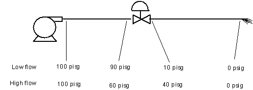

Valve Linearity: Installed characteristics
The flow vs. percent open curve changes due to the head loss in the piping
At low flow, the head loss through the pipes is less, leaving a larger differential pressure across the valve.
At high flow, the head loss through the pipe is more, leaving a smaller differential pressure across the valve.
The effect is to increase the non-linearity of most valves.

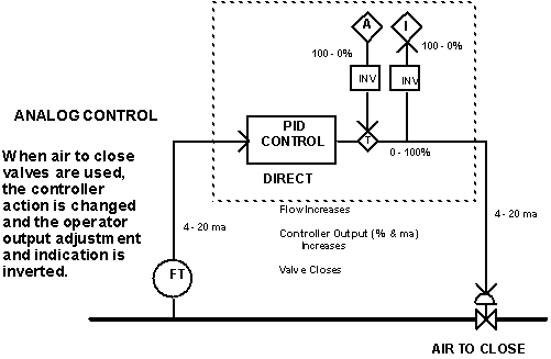

1.3 Fail Open Valves
Valves are usually either: Fail Closed, air to open or
Fail Open, air to close
  • Regardless of the way the valve operates, the operator is interested in the knowing and adjusting the position of the valve, not the value of the signal. "Up is always open"
  • All controllers have some means of indicating the controller output in terms of the valve position. When the operator increases the output as indicated on the controller, the valve opens.
Indication Inversion
The output indication is inverted.
The controller action takes the valve action into acount.
The flow loop is direct acting.
Most analog controllers work like this.

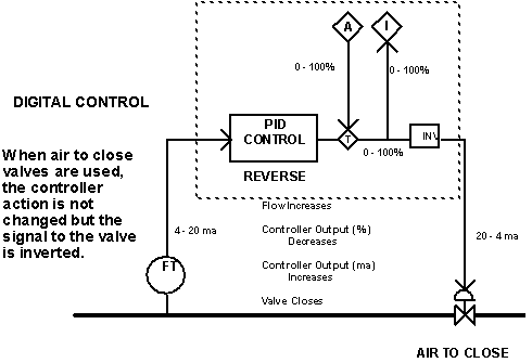

Signal Inversion
The output signal is inverted. The controller action ignores the valve action.
The flow loop is reverse acting. Some distributed control systems work like this.

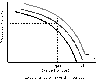

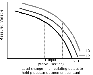

Steady state relationships: changing load
When the load changes, either the process value changes or the valve position must be changed to compensate for the load change.

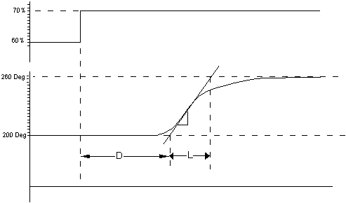

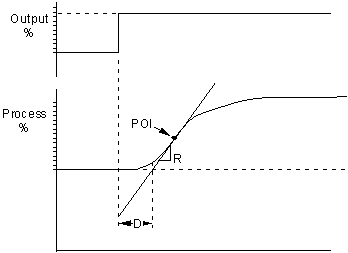

2.4 Measurement of dynamics
The dynamics differ from one loop to another.
However, they usually result in a response curve like this:
L is Lag—the largest lag in the process loop.
D is "Pseudo Deadtime"—the sum of the deadtime and all lags other than the largest lag.

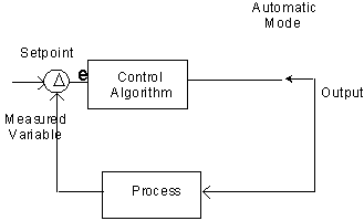

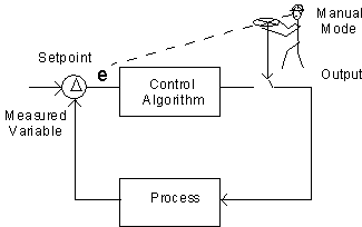

3.2 Auto/Manual
Manual Mode:
The operator adjust the output to operate the plant.
During startup, this mode is normally used.
Automatic Mode:
The control algorithm manipulates the output to hold the process measurements at their setpoints.
This should be the most common mode for normal operation.

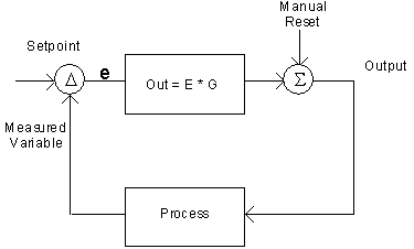

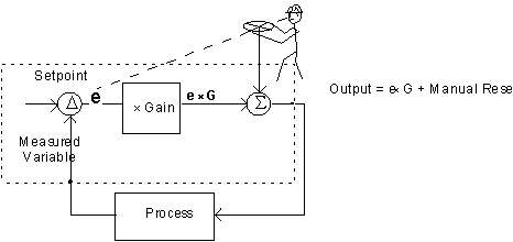

3.4.1 Proportional
E = Measurement - Setpoint (direct action)
E = Setpoint - Measurement (reverse action)
Output = E * G + k
The output is equal to the error times the gain plus the manual reset.
If the manual reset stays constant, there is a fixed relationship between the setpoint, the measurement, and the output.

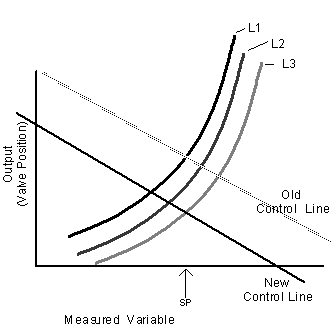

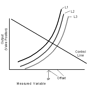

Proportional—Output vs. Measurement
(Reverse acting)
Proportional only control produces an offset. Only the adjustment of the manual reset removes the offset.

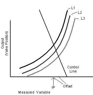

Proportional—Offset
Offset can be reduced by increasing gain.
Proportional control with low gain
Proportional control with higher gain
Proportional—Reducing offset with manual reset
Offset can be eliminated by changing manual reset.
Proportional control different manual reset

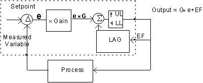

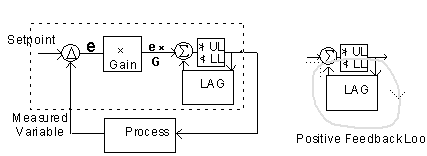

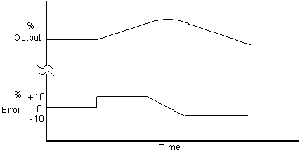

3.5 Adding automatic reset
With proportional only control, the operator "resets" the controller (to remove offset) by adjusting the manual reset:
This manual reset may be replaced by automatic reset which continues to move the output whenever there is any error:
This is called Reset or Integral Action.
Note the use of the positive feedback loop to perform integration.
Reset or integral mode
Reset Contribution:
Out = g X Kr X integral of error
where g is gain, Kr is the reset setting in repeats per minute.

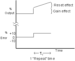

Units used to set integral or reset
Assume a controller with proportional and integral only.
Calculation of repeat time: (gain and reset terms used in controller)
With the error set to zero (measurement input = setpoint), make a change in the input and note the immediate change in output. The output will continue to change (it is integrating the error). Note the time it takes the output to, due to the integral action, repeat the initial change made by the gain action.
Some control vendors measure reset by repeat time in minutes. This is the time it takes the reset (or integral) element to repeat the action of the proportional element.
Others measure reset by repeats per minute.
  • Repeats per minute is the inverse of minutes of repeat
This document will use repeats per minute.

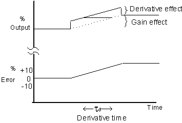

Derivative Contribution:
Out = g x Kd x de/dt
where g is gain, Kd is the derivative setting in minutes.

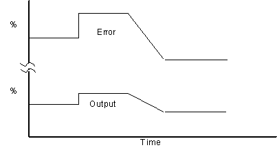

Response of controller with proportional and derivative:
The amount of time that the derivative action advances the output is known as the "derivative time" measured in minutes.
All major vendors measure derivative (Derivative, Rate) the same.

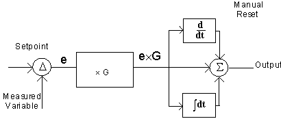

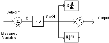

Complete PID response
Non-Interactive (text book) form:
Out = G(e + R+ D )
Where
G = Gain
R = Reset (repeats per minute)
D = Derivative (minutes)

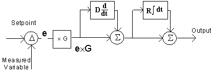

4.1 Interactive or Non-interactive PID Algorithm
"Interactive" and "Non-interactive" refer to interaction between the reset and derivative terms. This is also known as "series" or "parallel" derivative.
Almost all analogue controllers are interactive.
Many digital controllers are non-interactive, some are interactive
The only difference is in the tuning of controllers with derivative.
Non-Interactive (Parallel):
Out = G(e + R+ D )
Interactive (series):
Out = (RD+1)G(e + R+D )

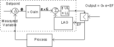

4.3 External feedback
The integral function implemented using a positive feedback.
If the input to the positive feedback loop is taken from the signal to the process, it is called "external feedback" or "reset feedback". At steady state the controller output is the Gain multiplied by Error added to external feedback. If the error is zero, the output is equal to the external feedback.

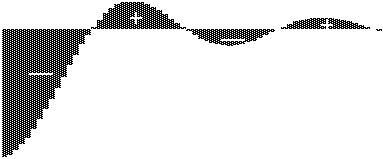

Mathematical criteria
Mathematical methods—minimization of index
IAE - Integral of absolute value of error
ISE - Integral of error squared
ITAE - Integral of time times absolute value of error
ITSE - Integral of time times error squared:
  • These mathematical methods are used primarily for academic purposes, together with process simulations, in the study of control algorithms.

Ziegler Nichols tuning method: open loop reaction rate
Also known as the "reaction curve" method
The process must be "lined out"—not changing.
With the controller in manual, the output is changed by a small amount.
The process is monitored.
The following measurements are made from the reaction curve:
X % Change of output
R %/min. Rate of change at the point of inflection (POI)
D min. Time until the intercept of tangent line and original process value
The gain, reset, and Derivative are calculated using:
GainResetDerivative
PX/DR--
PI0.9X/DR0.3/D-
PID1.2X/DR0.5/D0.5D
Ziegler Nichols tuning method: open loop point of inflection
Another means of determining parameters based on the ZN open loop.
After "bumping" the output, watch for the point of inflection and note:
Ti min Time from output change to POI
P % Process value change at POI
R %/min Rate of change at POI (Same as above method)
X % Change in output. (Same as above method)
D is calculated using the equation:
D=Ti - P/R
D & X are then used in the equations on the previous page.
Ziegler Nichols tuning method: open loop process gain
Mathematically derived from the reaction rate method.
Used only on processes that will stabilize after output step change.
ResetDerivative[/td]--[/td]0.3/D-[/td]0.5/D0.5D[/td]
Gain
PL/GpD
PI0.9 L/GpD
PID1.2 L/GpD

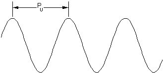

Ziegler Nichols tuning method: closed loop
Steps
Place controller into automatic with low gain, no reset or derivative.
Gradually increase gain, making small changes in the setpoint, until oscillations start.
Adjust gain to make the oscillations continue with a constant amplitude.
Note the gain (Ultimate Gain, Gu,) and Period (Ultimate Period, Pu.)
The Ultimate Gain, Gu, is the gain at which the oscillations continue with a constant amplitude.
GainResetDerivative
P0.5 GU
PI0.45 GU1.2/Pu
PID0.6 GU2/PuPu/8
