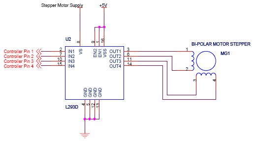

according to this image i want to know the diagram between the micro controller and the l293d ic ;) with the power supply
Re: How to drive a CD-Rom motor with PIC microchip??
Post by Neo » Sat Sep 10, 2011 11:09 am
Just connect pins of PORT B (PB0, PB1, PB2, PB3) to Controller Pin 1, 2,3 and 4 respectively.
If your motors are 12V, then connect 12V to "stepper Motor Supply". Connect the same 5V supply you used to give power to the microcontroller (PIC). Connect all grounds together.
then? thats it?? :shock: how do i supply current to the PIC?? :roll:
ya its a 12v motor ;) that means 12+ should be connected to the "stepper Motor Supply" and the 12- should be connected to the "ground"?? :roll:
PIC needs to be powered with smooth 5V. We have supplied you a 7805 power regulator for this.
+12 - ( - 12) = 24V...so it is not correct. You need connect the centre tap to the ground.
