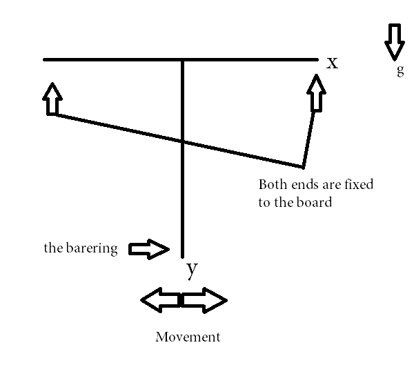

if we mount it vertically, we dont need another motor right?? ;) because the "x" axis is fixed to the board it should move!! like this in the picture :)
I already understood the design. My concern is whether the bearing can hold the friction and vibration of motors? If you are going to plot 1mm dots, it really matters. When X axis moves, if Y bar can travel the same distance and stop at the same point as the other end, it is okay. But in practical terms, my feeling is, it will stop 1 or 2 mm behind the target (due to friction, vibration of motors and little lose space in the T joint). If that error is > 1mm, then you will see it on the drawing. If you have used a similar setup on the other end, you command the motors to exactly move the same distance, so it is guaranteed that both ends will stop exactly at the same location. Okay, let's do some experiments to see whether the error is > 1mm. If it is less, then it is hardly noticeable on the drawing.

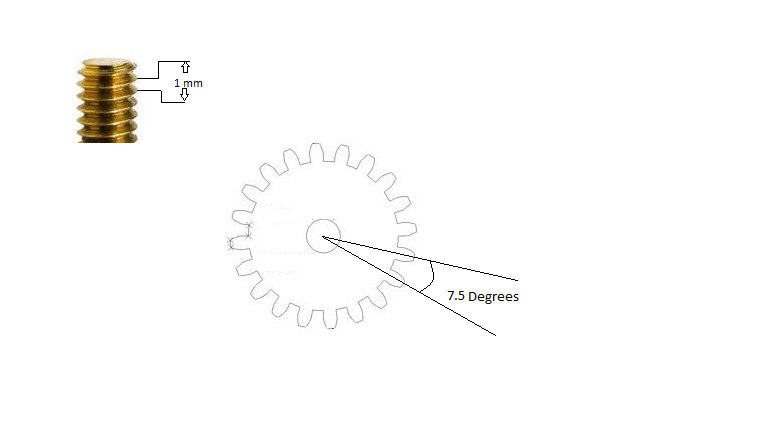

In our stepper motors there are 7.5 degrees gap between every step.So it needs 48 steps to finish a full round.(360/7.5=48)
There is a 1mm gap between two threads of threaded rods.When we rotate it one round,total displacement is 1mm.So we can mark 48 different positions within a one millimeter.We don't need a such accuracy.But the problem is according to our method the drawing will be drawn by small lines.Not by a single line.So it will be like a printer.That is the problem now we are facing. :?:
