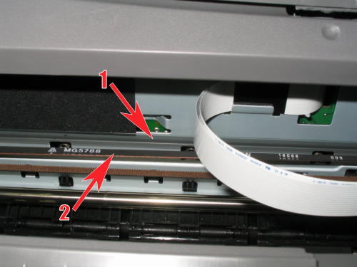

I think You have identified it correctly. There are printers that comes with a DC motor to move the cartridge. However you might have already noticed a thin plastic strip with 1000s of tiny black lines? This is called an encoder. By using a photo-transistor, the distance travelled is measured using this method. Since the measurement is read back in this way, this is referred as a servo system.
Have a look at following images.
Linear encoder:
1 - Encoder strip (semi-transparent gray strip)
2 - Carrier belt (black and brown toothed belt)
Rotary Encoder:
