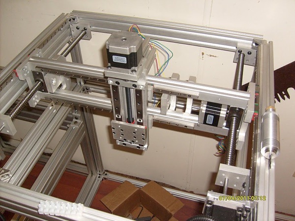

Found a nice image of a 3D printer. Thought it would be helpful for you guys.
For more info, see CubeSpawn.
