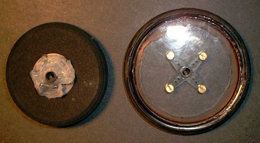

1.Servos
You can use servos for easy to get gear
motors. Hobby shops will usually carry several sizes and brands. You
will need to modify them for use there are many sites on the net with
different methods; the one I like is detailed at the PARTS website at http://www.portlandrobotics.org/.
Servos already have all of the control circuitry built in and are easy
to control they have 3 wires signal, +, and ground by pulsing the
signal line you can go forward, stop, or backward. Servos are probably
the easiest and cheapest way to go but may not be the best for you.

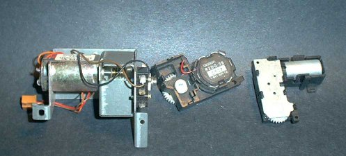

2.Gear motors
These are available from surplus stores or hobby shops
some people modify servos and remove the electronics to use them as
gear motors. Gear motors will require control circuitry normally an
H-bridge to allow forward and reverse motion and in some cases braking.
Gear motors can give the greatest flexibility but at a higher cost
compared to servos. Another source for gear motors is the toy section
of your locale department store. What you want are the radio control
toys that have differential steering, meaning they have a separate
motor for each side. To turn left they go forward on the right motor
and turn off the left motor and do the opposite to turn right. The
really good cars will turn right by going backward on the right motor
and forward on the left this will allow a vehicle to almost turn on a
dime. If you use gear motors you will need to devise a method to mount
the wheels I will be using a toy for my example.
Wheel Selection
You can use wheels from toys or you can buy wheels from a hobby shop
they have pneumatic or foam wheels for model aircraft that are very
easy to use.
