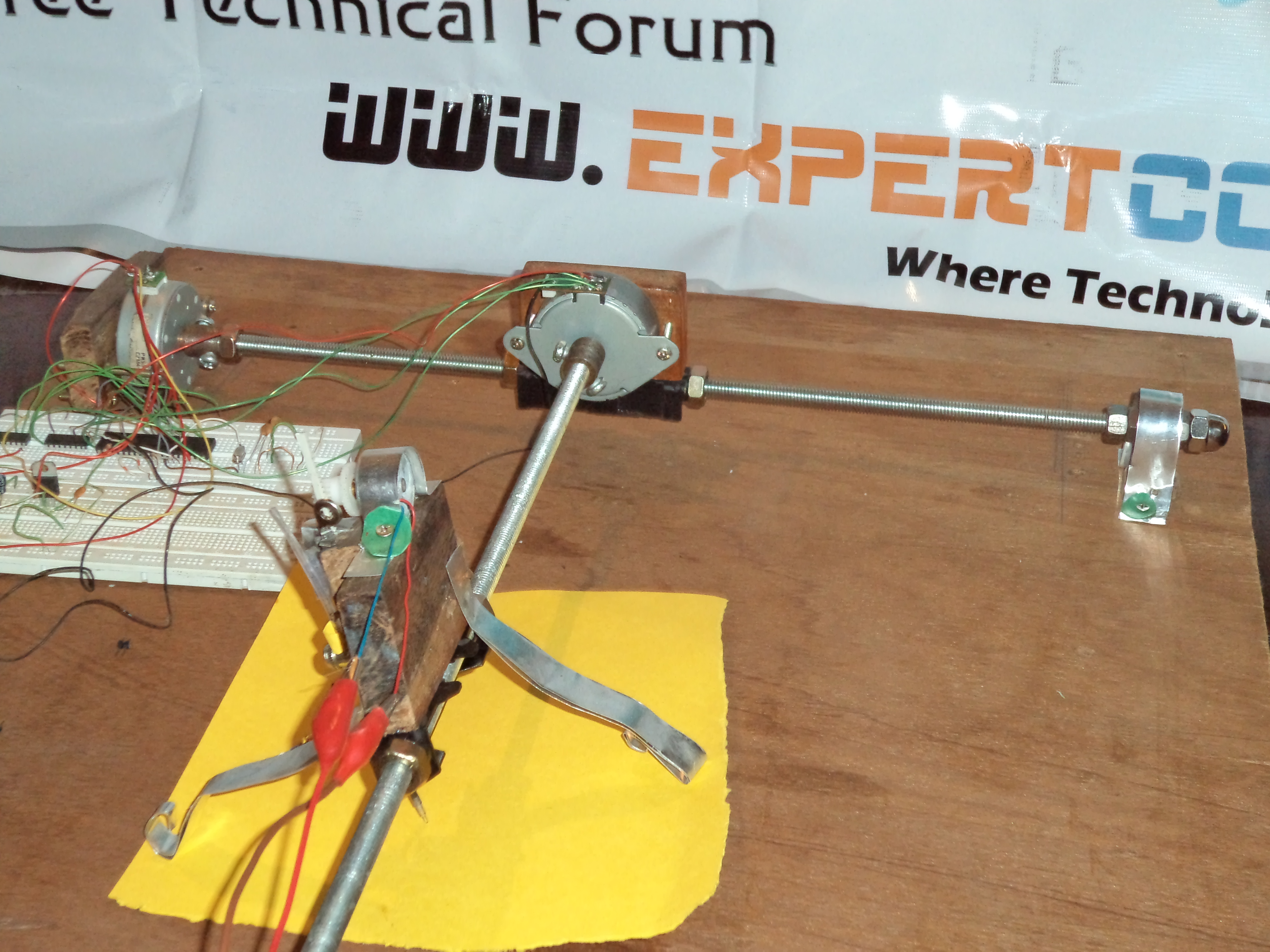

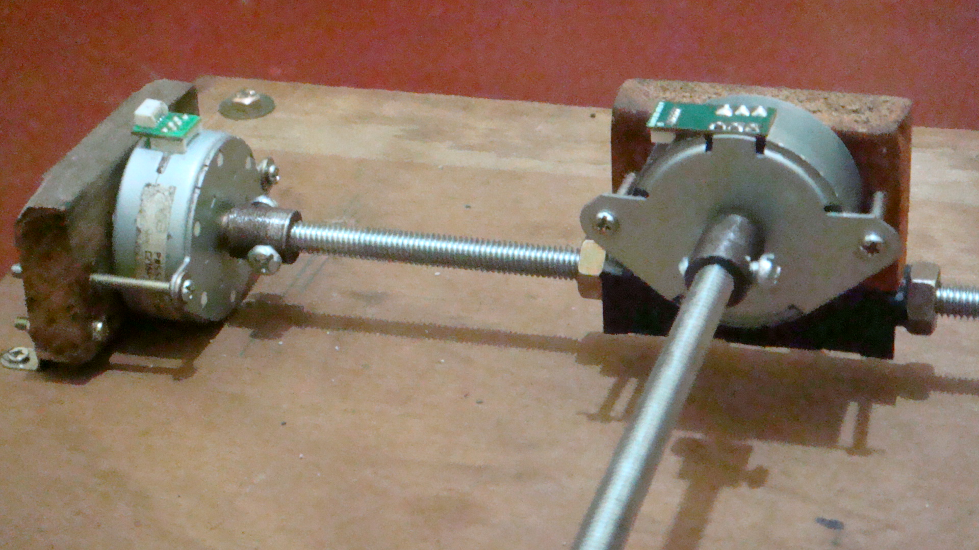

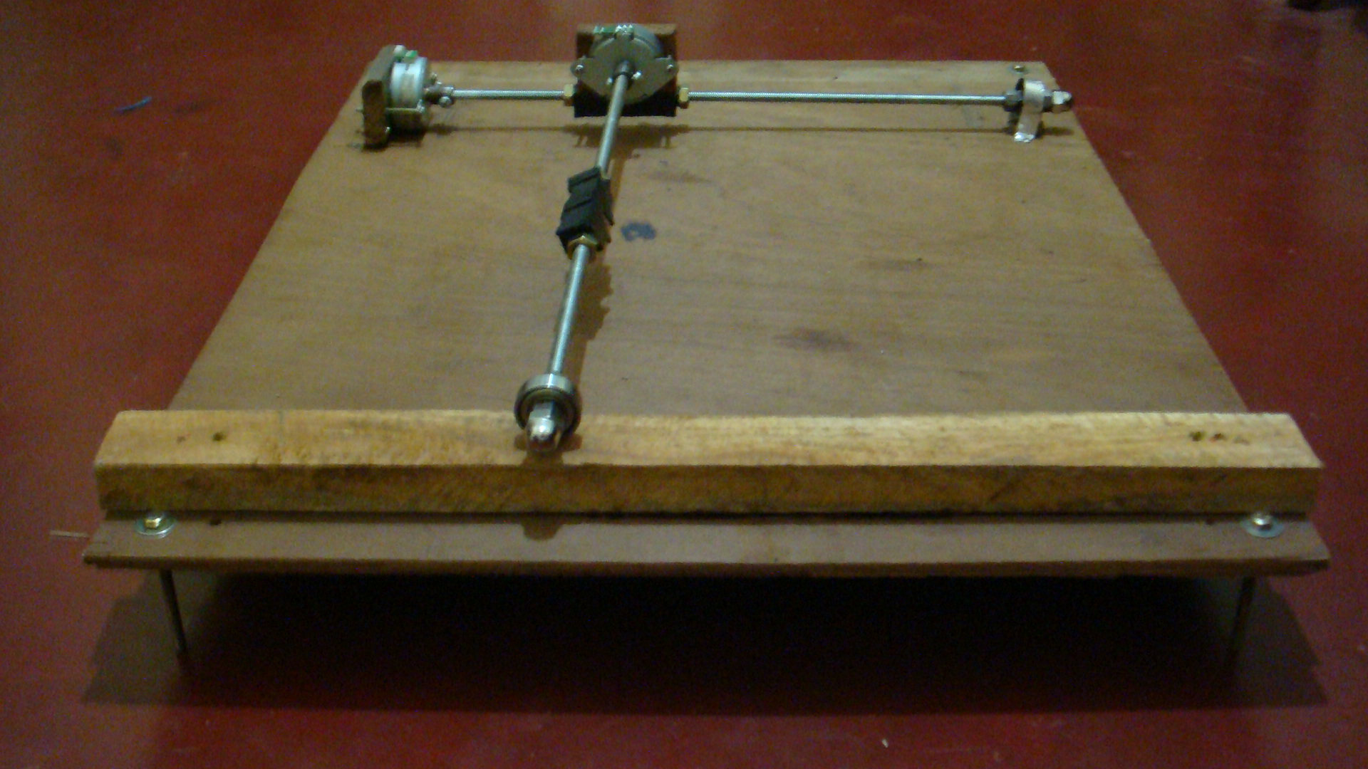

Here are some pictures of drawing machine.
Sorry for late updates :oops:
Drawing Machine
Drawing Machine
Drawing Machine
Drawing Machine

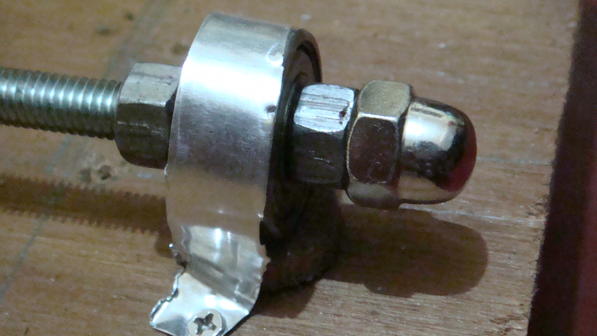

End of Y axis
End of Y axis
End of Y axis.JPG (804.74 KiB) Viewed 41811 times

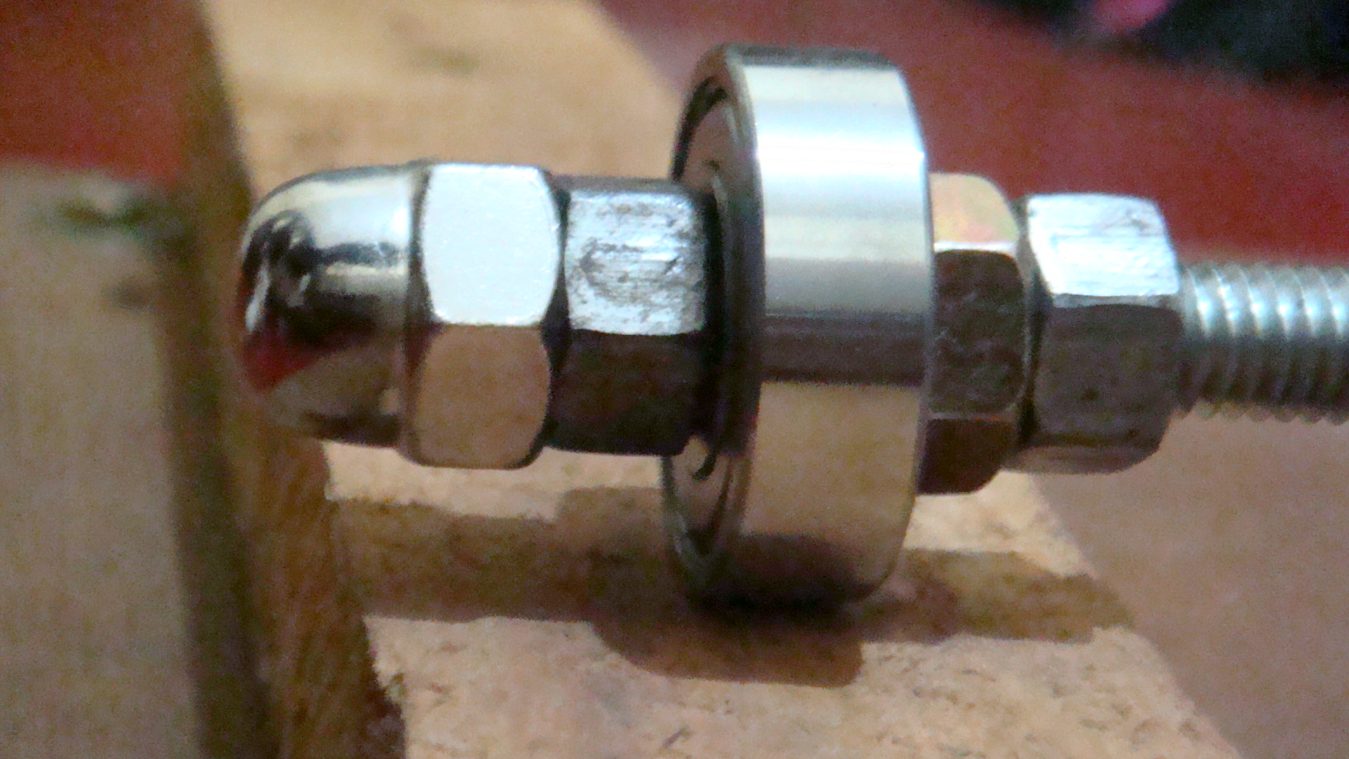

End of X axis
End of X axis
End of X axis.JPG (652.27 KiB) Viewed 41811 times
X and Y axis
X and Y axis
X and Y axis.JPG (796.33 KiB) Viewed 41811 times
Re: how to build a drawing machine
Post by Neo » Thu Sep 08, 2011 10:42 pm
Very nice. Praveen has done a good job. I would like to give a little idea. I think it would be better if you could use another stepper motor instead of the free wheel. It could otherwise be inaccurate when the pen is loaded with some friction. Just an idea. I know time has already become a problem.
Shenal
Posts: 29
Joined: Tue Feb 09, 2010 3:29 pm
Location: Wattala
Post by Shenal » Thu Sep 08, 2011 10:49 pm
How about line bearings without an other stepper :?:
Post by Neo » Thu Sep 08, 2011 10:54 pm
As long as it can handle the friction of the pen, technically a bearing is okay. However in practical terms, you will have to do some additional work to get it to work. Since this topic is very long, please start a new topic for other questions.

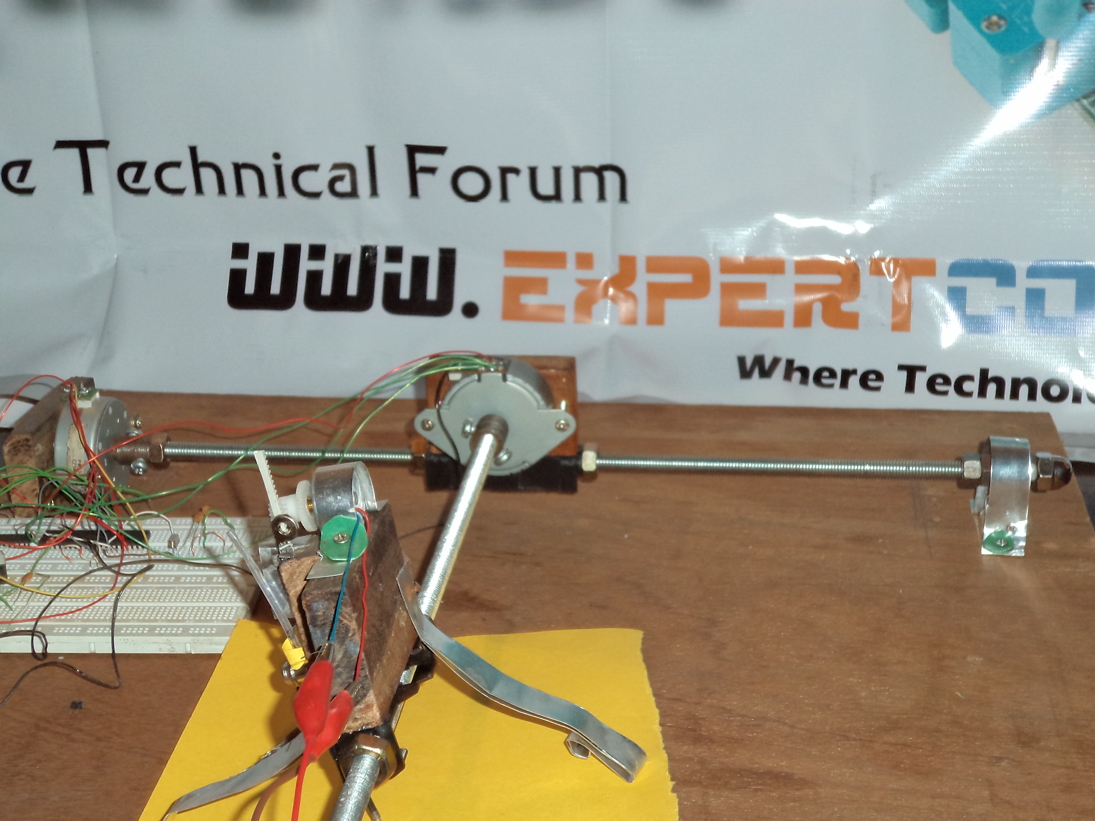

Post by Shenal » Sat Dec 17, 2011 3:34 pm

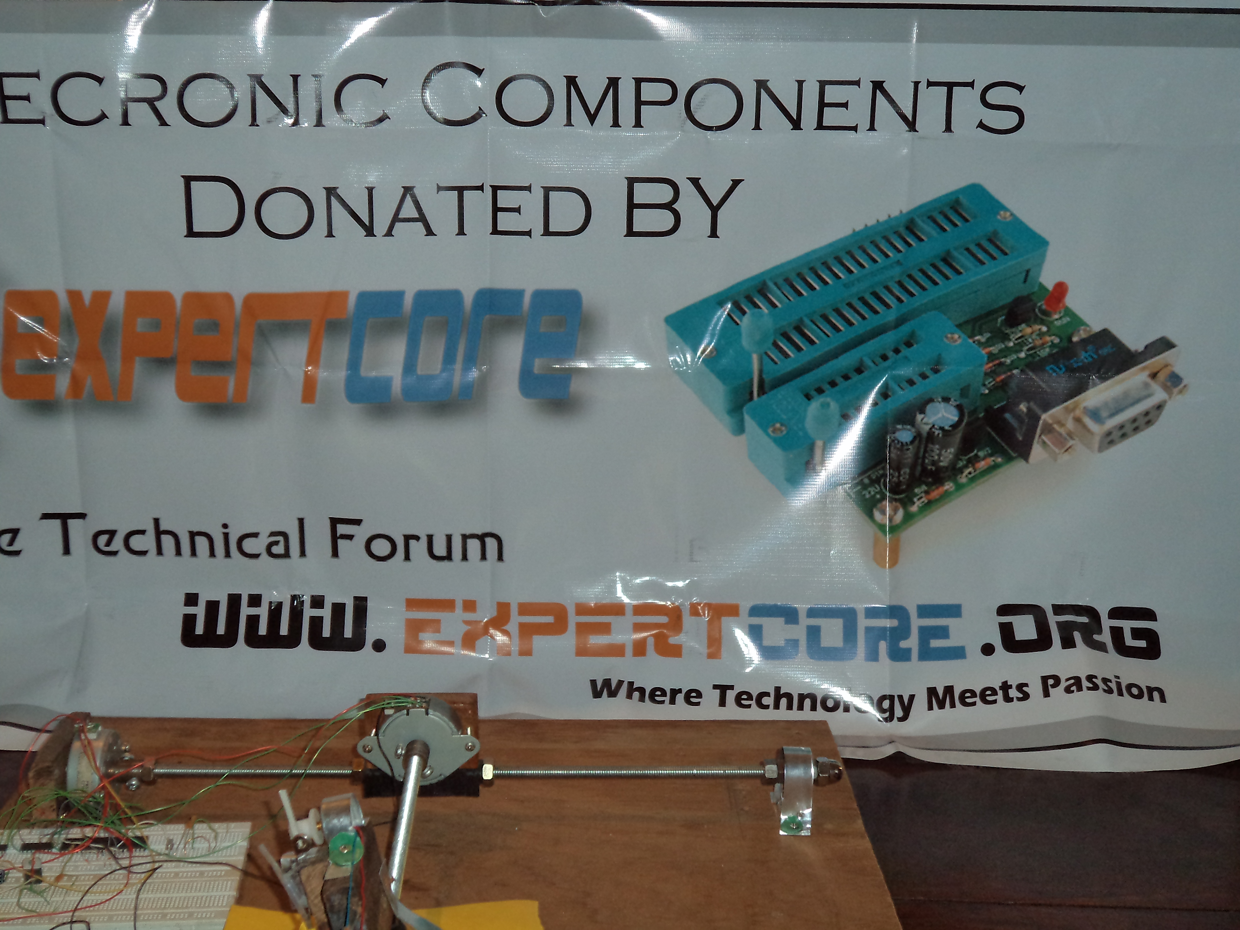

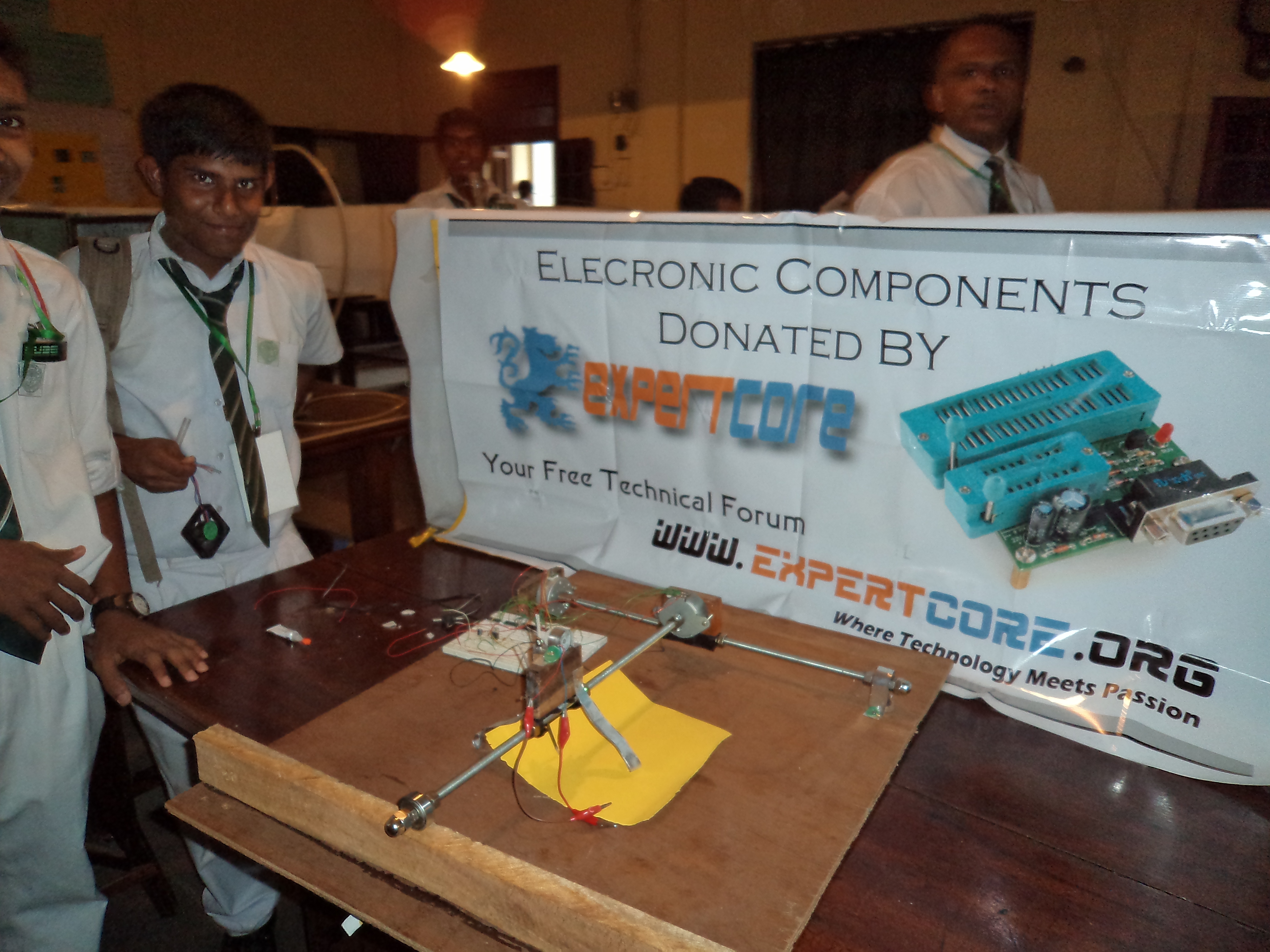

Our Exhibition
Our Exhibition
Images of the Drawing Machine(Without USART)
