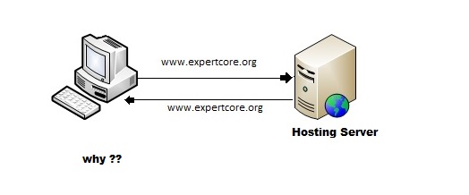

Why Client can't access Hosting sever Direct with out DNS

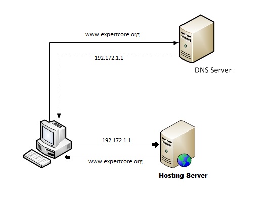

Post by Face » Sun Dec 16, 2012 8:16 pm
this the way that I got the Idea about DNS,Browser,Hosting Server. (Correct me If I am wrong )
first Client (Browser) request a URL(https://robot.lk) it goes to DNS & DNS translate the URL to an IP address (192.172.1.1.) & after that browser use the IP address to locate the host server & send a request for the content.
I wanna know that why the Browser can't access the Host server using the URL to get the content?

Re: Why Client can't access Hosting sever Direct with out DNS
Post by Rksk » Mon Dec 17, 2012 12:13 am
Hi,
You are here, after a long time...
Different websites are hosted in different servers worldwide. So our brower don't know where the website is hosted. It can't find the server by domain name. Then the browser requests the IP of the website (domain name) from a DNS server and connects to the IP.
That is my idea. Also google may help you, http://www.google.com/search?q=why%20dns

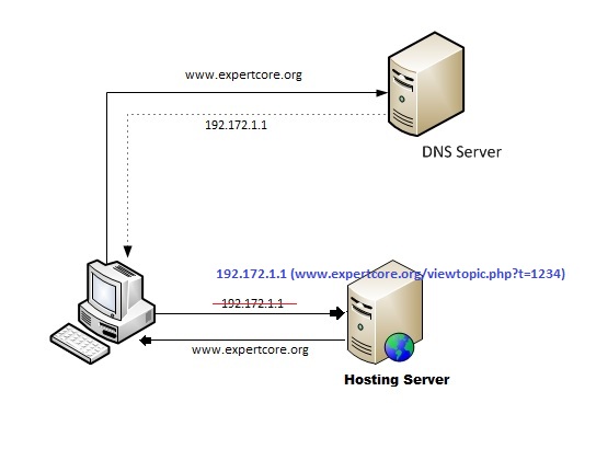

Post by Neo » Thu Dec 20, 2012 6:03 am
There is a little clarification to your image. It should be as follows.
When you request a page as "www.epxertcore.org/viewtopic.php?t=1234", the browser extract the domain name and send to DNS to get the IP. Then the browser passes the data packet with HTTP request to that IP. Within that HTTP request, we have the whole address, so that the web server running in that IP will intercept the packet and divert to the correct virtual host. A single web server can be used to host many web sites (domains). For example, if you take our current server, ROBOT.LK.org, Expertcore.com, all are in one server. Web server is the one understands this using the HTTP request and direct it to get correct data.
Domain to IP table is just one thing a DNS does. It uses CNAME record type to define this. Do you know that it is possible to keep website in one server and email on another ? It is possible through MX record of the DNS server. So under a domain name such as robot.lk, we can define where our web files are hosted using CNAME and where the emails should go using MX record. Have a look at list of DNS records. http://en.wikipedia.org/wiki/List_of_DNS_record_types
If DNS servers are not there, the world will be only with IPs. No multiple domains couldn't be running in a single IP, etc... Not only that, you would have to memorize numbers. Or else, you need to program the browser to have this database locally which billions of sites would make it take hours to download a browser software such as Firefox.
