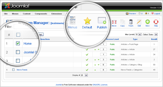

If you receive a '404 - Component not found' error in Joomla 1.5 error when going to your main page you should check whether you have a default menu item published. Joomla needs a default item for the front page. In order to do this, go to your admin area -> Menus -> Your main menu. Then select the menu item that you want to be loaded when you visit your main page and click on the "Default" button at the top-right of the page.
