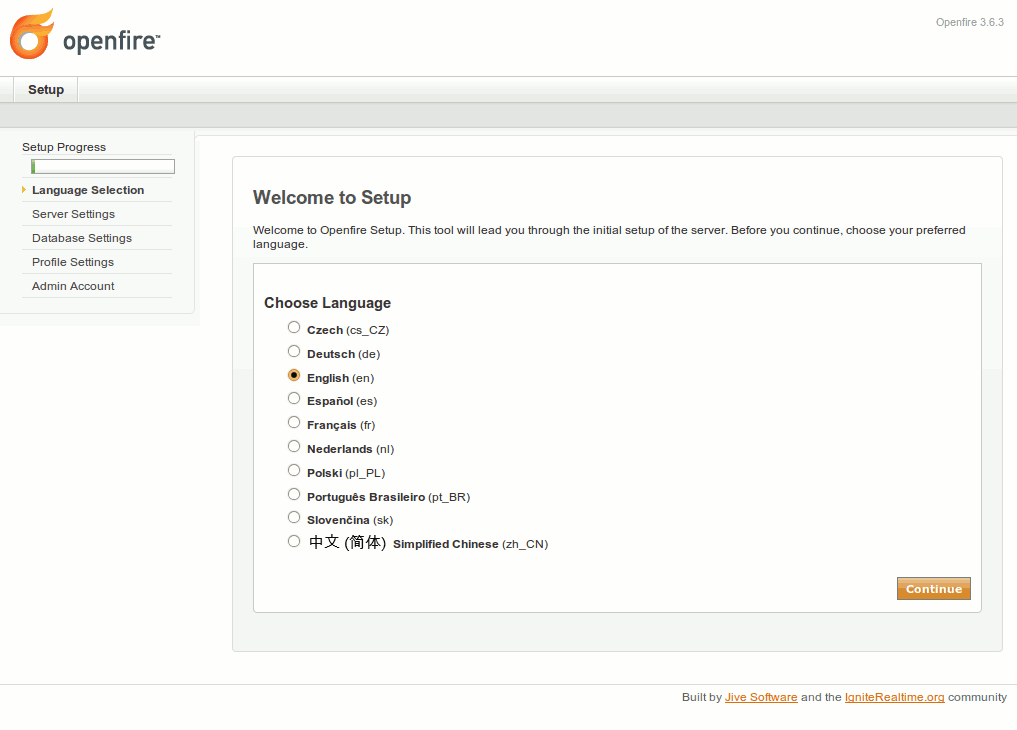

    1. Language selection is first

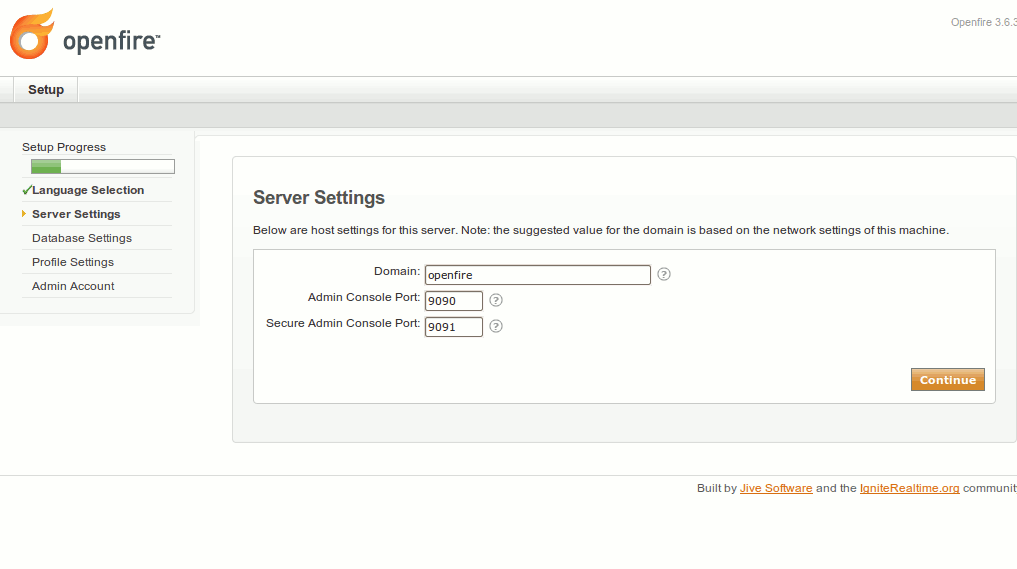

    2. Next you'll specify some basic server settings. For simple deployments, it's best to leave the defaults in place.

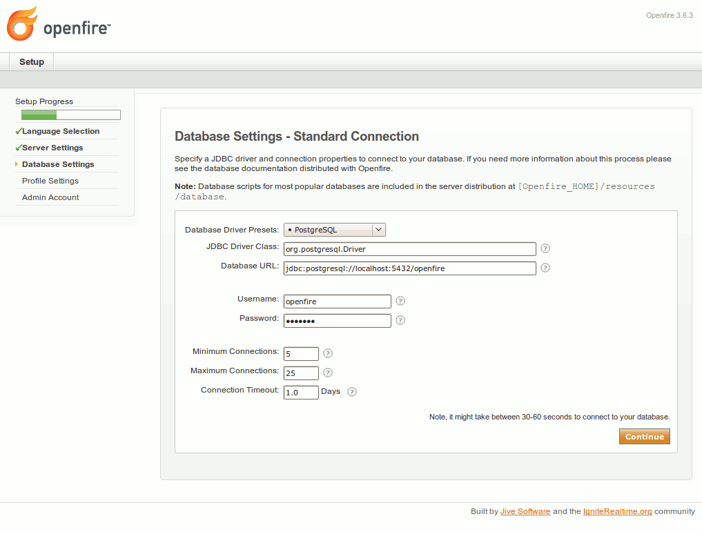

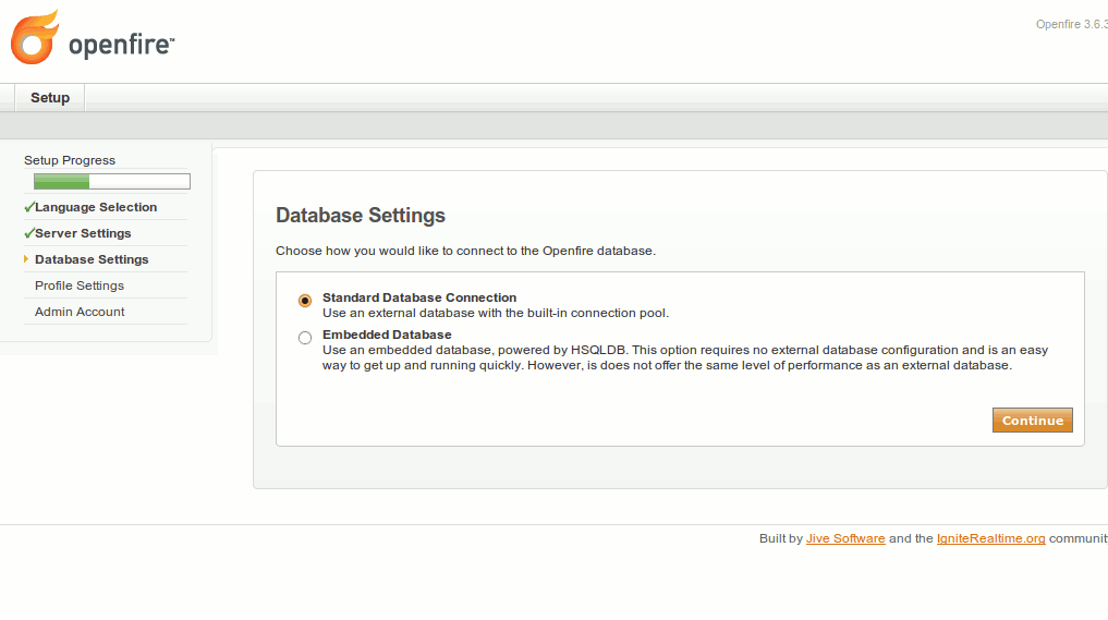

    3. For the database setup step, specify a standard database connection and enter your Postgresql database information.

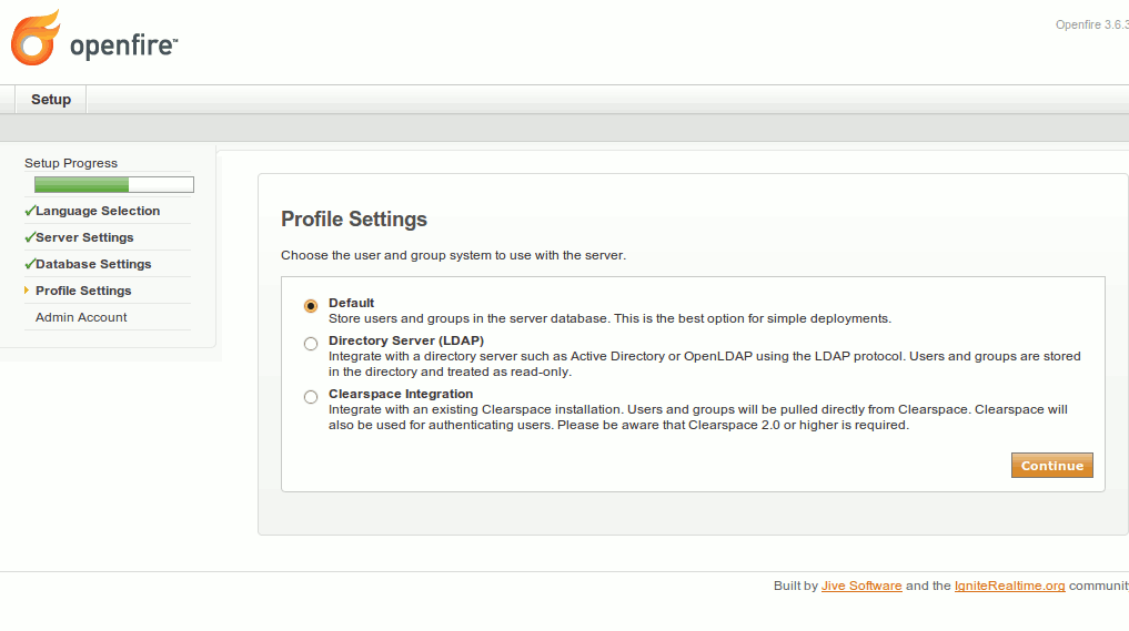

    4. Unless you really know what you're doing (i.e. you have an existing LDAP environment), leave the default profile settings in place.

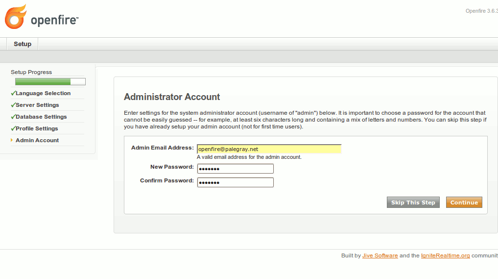

    5. The last step in the installation is to set up your administrator account.
  8. Though you have set password correctly you will mostly not be able to login.
    To fix this, open your database and open ofUser.
    Run following SQL.
    update ofUser set password='123456', encryptedPassword = null where username ='admin';
  9. Now we need to restart the Openfire service
    service openfire restart
  10. Now login using admin and 123456 as set before.

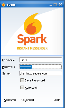

  11. Next, install Spark (The chat client of Openfire)
  12. Enter user, password and your server.
